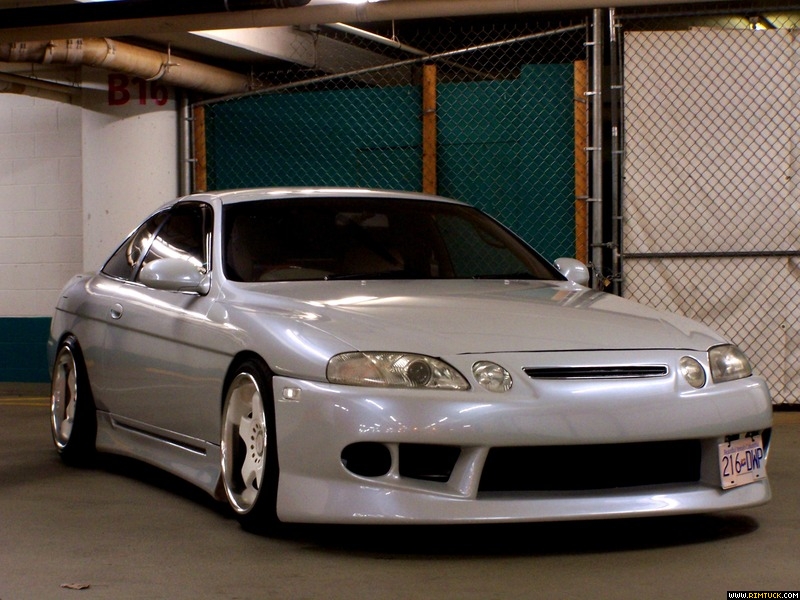

Well, what color is your car? Maybe if it's black and you're going for the stealth look...
But fitment shouldn't be to far off from this, right guys?
18x9.5+16 225/40
18x10.5+16 245/40
The wheels you're looking at have a higher offset by 2mm compared to these. So, they shouldn't stick out any further than this pic...
