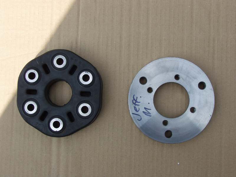

I got some pictures of what I would like to do and see if it's possible.
Our SC's have this:
I would like this on it:
To make it easier could I pull the original SC flange off and slap on the one from the second picture?

You may want somthing like this to replace the rubber flex-coupler. Try PowerhouseRacing.

First of all, go and take a look at the one you have. Personally, when i took mine out, it was all cracked and dry, it looked like it was about to go. My car has only 90,000 miles. Second of all, none of the moderate powered supra run them, why? because they granulate them after few launches. Last but not least, i have the alloy adapter and my ride is as smooth as ever!

While you're at it, get the steel adapter! It makes sense to me and anybody who runs more than 150 whp
