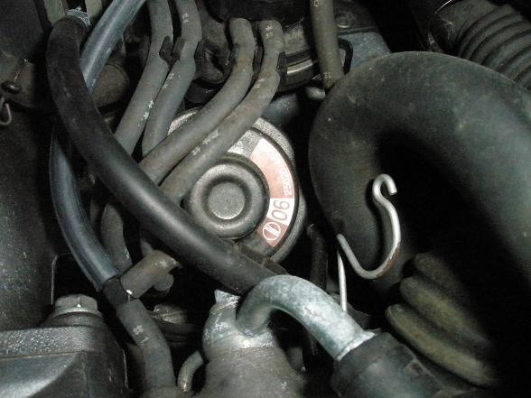

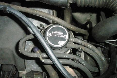

im getting the same code 71. i took pics of the egr system so can somebody help me and tell me which one i need to clean or replace. oh and also if anybody knows if a leaky hose would be the problem. i replace one of the hoses becuz it was so brittle that it had a crack and it looks like mostly all of them are the sameway.

another pic
