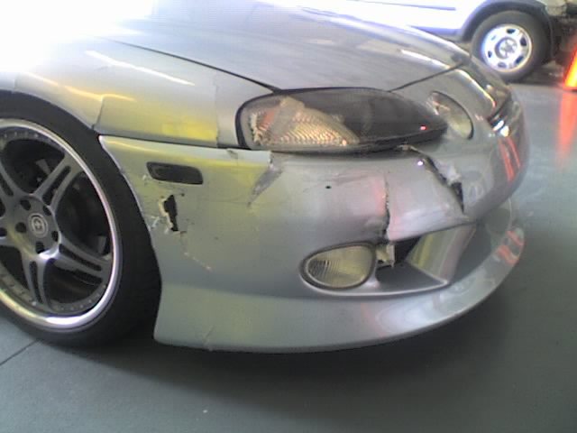

still at the bodyshop. was in an accident that resulted in this
was almost close to getting totalled out. i'll be getting the car back tomorrow, hopefully in a condition where i don't have to worry bout any complications with the mods. will update tomorrow.
