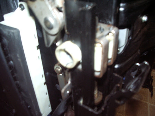

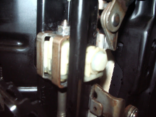

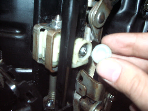

I think a lot of us have had at least one seat that did not slide forward or backward properly, for some of us it never slides at all. There is a thread or 2 somewhere describing how to fix it, but pictures are just so much better.
Heres my way of saying thanks back to the Club Lexus community.
cause really.. a Lexus with broken power seats is really just a no no!
Here we go, this is the passenger seat btw.

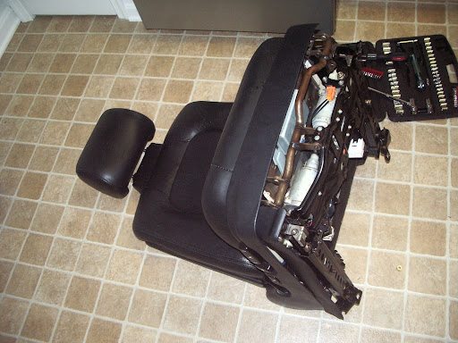

1. Remove seat *this can be hard when your seat is stuck all the way forward or back* get all the wrenches you have.
2. Look at bottom of seat
3. Locate white box on either side of the seat towards the back
4. Insert cap into place if you still have any *Search your car for em* they can pop out
5. Repeat for other side
If you like me had one of the caps missing entirely, you will have to go order the part.
** EDIT ** so after 10 years doesn't seem like there is a way to order new ones, so you have to find spares from another set or come up with another solution.
the side of the worm gear closest to the motor is the one that pushes outwards on the cap with the most force. this is likely the one that has popped out or broken.
So there it is, no big deal. do yourself a favor and buy the caps before hand
then you wont have to worry about how to rig it up.
from removal to fix to install, 30 minutes if you have the caps.

i had a tough time removing mine when it was stuck all the way forward too. there is a bolt somewhere on the side that will manually slide the whole rail, but i didnt figure that out until I had the whole seat out.
I had my mechanic get really creative with some wrenches to get to the bolts that hold the seat in. its tough but can be done
there is a cap on each side, one holds alot of pressure when its being turned and the other requires minimal pressure to keep in place. chances are the one that popped off is the stronger one. i would try (this worked for me) if you still have one cap on, swapping it to the other side, and the side that has less pressure is the one you can turn to turn both sides, thus sliding the seat.
I know that doesnt make a whole lot of sense, but once you get down there you will see what i am talking about. the side that turns both of them is the side closest to the motor. looking at pic number 2, this was the left side for this seat (i think thats the passenger seat) hope that helps.

Just want to add this , if the cap on the outside facing the door is missing...you can actually get to it without removing the seat....
Raise the seat height up all the way it will give you enough clearance to install new cap...If the screw is pop out you can push it in with a screwdriver while you lightly push on the button that moves the seat forward or backward( fiddle with it )
Or just find a socket that fit , push in while you turn the socket it will go back in..Then install the cap, hope this help

if only one side is sliding, that means the other side the wormgear must have popped out, there is one for each rail. I don't get what you wasted 3 hours on? if you dont have a cap, you have to hold in the wormgear in while trying to use the switches, or even when manually trying to move the rail.

Ali SC3, thks for posting the pics. You are exactly right with the pics/description. That is what happen on my pass seat. The only way to get to the seat mounting bolt (since I could not move the seat on its rail) ,I had to grind down the sides of a socket, so as to be able to get a spanner wrench onto the socket that fit over the head of the very hard to get to bolt. This allowed me to get the proper torque on the hard to get, mounting bolt. If I am not mistaken, I also had to put the spanner wrench(cheap China made) in my vise to bend the darn thing at about a 30 degree angle, so I could work the socket/bolt head under the seat. Nothing like fabing up your own specialty tools, but worked like a charm. Kept the "new" tools in case I encounter the problem again.
