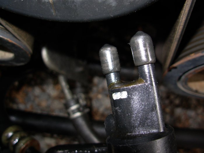

Here are the two vacuum lines that are reversed https://www.clublexus.com/forums/sho...9&postcount=45 Reverse them BACK to where they should be at the pump. They are side by side and easy to confuse.
When they replaced the PS pump they reversed the lines and it blows power steering fluid into the intake and causes white smoke. (ask me how I know) Which causes very poor performance because your heads and intake are filling up with PS fluid.
So you can now sue them for incompetence also, because they are idiots. If you go to your car and pull the black intake tube off at the intake you'll likely find PS fluid in there.
PS- DO NOT let them do this to your car, go get it and do it yourself or they'll screw something else up and blame it on a different part.
Sorry to tell you this but you just went through ALL THIS because of two reversed vacuum lines at the very beginning when you had the initial work done on the power steering pump.
Below is the part you are looking for. It has two hoses on it, swap them, they are backwards. You'll see it on the side of the PS pump. It would be easier to remove the intake tube and air box to get to it, but it can be done without removing the intake tube and air box.

PPS- it'll take about 5 miles or so to blow it all out of the intake so switch the lines and go drive it. With some luck there is not any other damage as a result of this stupidity.
I am putting a 100% guarantee on this as the problem and I never do that. Worse news is that your rack was likely ok also, you just needed a pump. I know people who have ran these racks DRY for long periods of time to avoid damaging the alternator when they had a leak (not recommended) and still not killed the rack.
