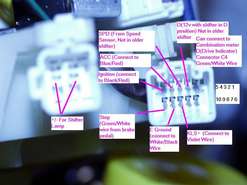

The newer shifter will bolt right into the old location. The wiring is the tough part. A few new wires are required to be used with the new shifter ecu. It needs an input from a speed sensor for example. Sorry I dont remember the complete list off the top of my head
I posted some pics awhile back, its no writup though.
gadgetSC-t
i was wondering if anyone actually did a full on write up for this mod.

This is as close to a write-up as I have gotten. This is the pinout of the gated shifter ECU. The new shifter assy will bolt right into the stock location. You may or maynot have to make an adjustment to the linkage between the transmission and bottom of the shifter assembly. The toughest part is getting your hands on the shifter assembly. Hope this helps.
gadgetSC

heck yes. that is awesome. thanks so much for that picture.
