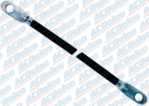

RockAuto.com sells this ACDELCO ground strap for the SC400 for only $5.70:
Part # 6ST14 CABLE,BAT NEG {#88860131}
**Non-stock item--shipping delayed up to 12 business days**
That's a great price, but would there be any advantage to getting an OEM cable?

A ground cable is a ground cable-- is a ground cable......" " " " " '
I described a really good way to do it in a previous post--
Single distribution block on firewall or on strut tower/s, then strap the back of each head to the grounding block/dist. block-- then the intake manifold, then the block/ trans---
Then ground the dist block to one or both strut towers-- just loosen one of the strut mount bolts and use that point after scraping any paint off the contact surface...
You don't have to get a fancy distribution block -- a standard electrical grade block from Lowes will work--
Yes it's overkill, but it will restore conductivity back to 100% + of what it was from the factory....
