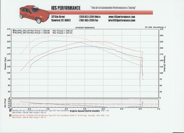

Please post your dyno graph on SC400
i will start first
http://www.dragtimes.com/1993-Lexus-...aphs-9719.html
I am running with a stock torque converter.
Only mods I have are NGK Iridium plugs, S-AFC 1 dyno tuned, Exhaust rear mufflers replaced ( 2 rear resonators removed), BFI intake system as in www.planetsoarer.com (mine is completly sealed off from engine bay, taking air from lower part of the front air chamber.
I notice a big difference in power after just intake and exhaust, also after tuning with S-afc noticed a big improvement.

Hey, 207whp is what I last dyno'd at also with my 1992 SC4 runnning with no ECU piggy and no nos...Your power curve leads me to believe you are running a aftermarket torque converter. Am I correct?.....
What I would like to know is what is the best dyno ever on an early model SC400 N/A, and still with the stock engine internals?....I saw one reach 300whp but it was sporting an eight throttle body intake, cams and side headers and exhaust.....Not exactly street legal with that type of intake and exhaust setup though... I have seen a few 220's.....
I notice a big differance in power after jsut intake and exhaust, also after tuning with S-afc noticed a big improvement.

Verylost, Without getting into it with you, I have a very difficult time believing that you picked up 20whp from just a tune job....That is amazing if it is true....I hooked and tuned my Safc Apexi and could only get 8whp and we tried tuning several times. Rich, Lean it didn't matter 8whp is the best I could come up with......Did you tune it extremely lean?...Advance timing? Maybe your stock ECU was out of whack? How is that possible?
I would love to meet your tuner....man.....
