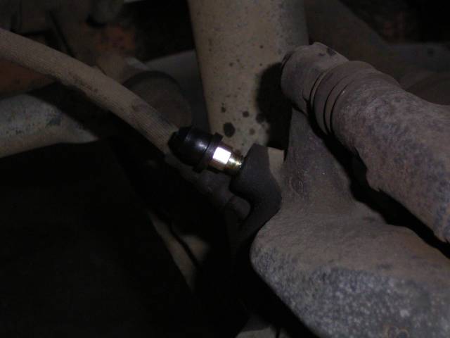

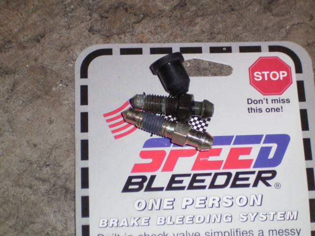

Ok... 100% sure now... it's 7mm. The ones I got were the SB7100. Works great!
https://www.clublexus.com/gallery/da...icture_136.jpg
https://www.clublexus.com/gallery/da...icture_138.jpg
