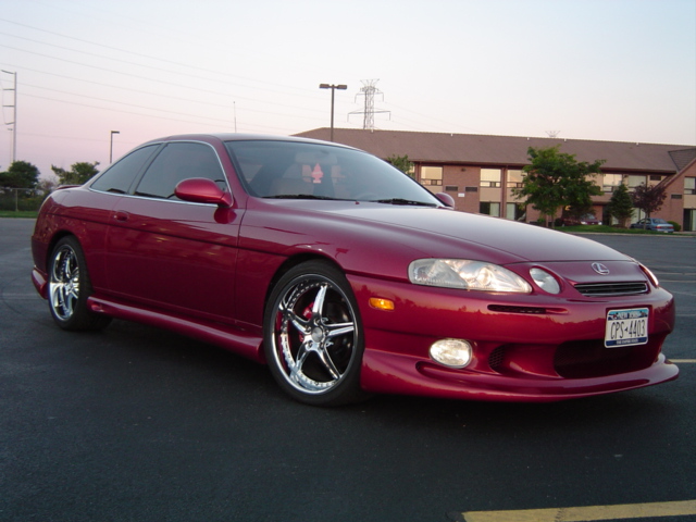

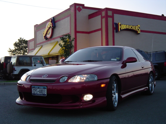

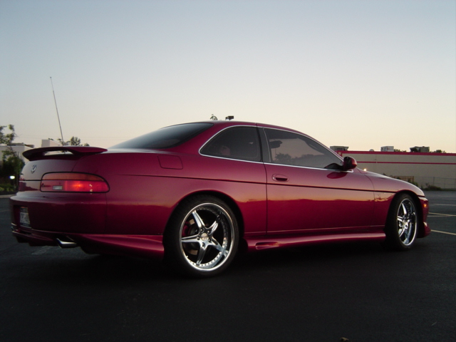

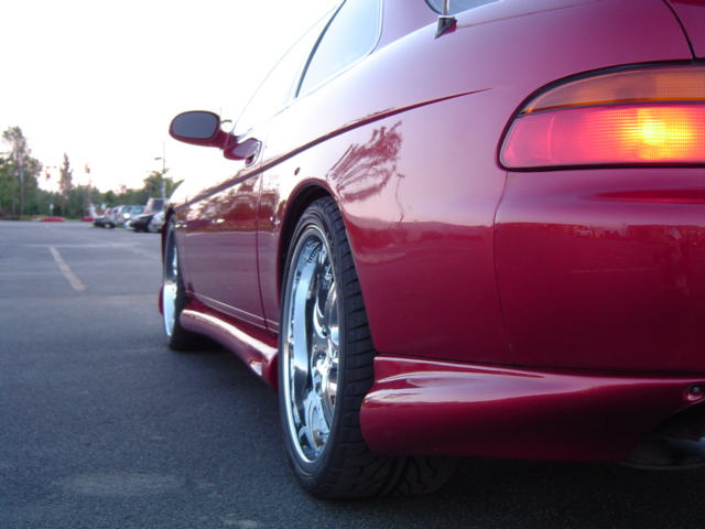

Just got the car lowered the other day...had some problem with car sits uneven on the rear, but my guy somehow fixed the problem....now both rear side are perfectly even....very nice and clears both rear quarter panels without roll or cut the rear fender lip....even with 19" wheels and 285/19 tires on the rear, NO rubbing or anything.....

damnn looks good
and no rubbing? thats awesome

Very nice...

That car is beautiful What kit is that?

yep- that sc is gorgeous- goes together perfect- any work done with engine?

very nice drop

Nice tire sizes. Drop looks good.

Very Clean...what type of springs and shocks/struts did you use?

It's the Bomex Aero kit. Has a really aggressive look to it. I really like the paint color on it!

What offset are your wheels and what suspension did you go with?

yes, those are the bomex G2 kit, and the wheels are 19x8.5 front and 19x10 rear with 38+ offset front and 30+ offset rear....fits PERFECT....and i have the stock SC shocks with 50k miles on them with Eibach prokit springs, 1.25 drop front and 1 drop rear (thanks gazi)......my car was sitting uneven on the rear, driver side was about 1.5" lower than the passenager....and my guy finally somehow fix it for me, he is on vacation until next week, but i will ask him when he come back.....thanks

IMO u need HID's really sets any SC off since we already have projectors..
