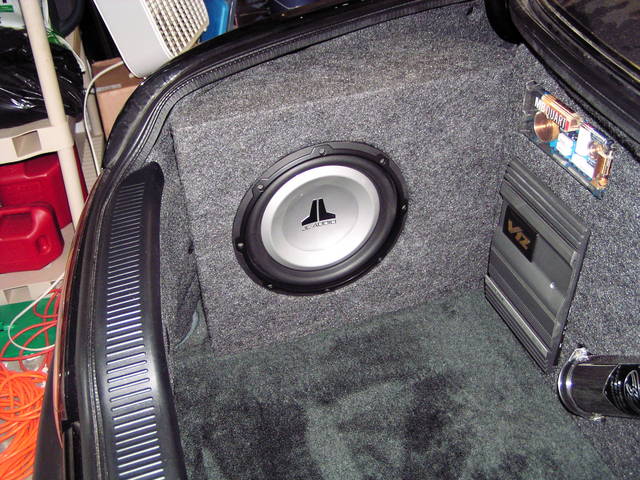

Here's mine...I installed the sub on the left, side, so it balanced out the weight...
Ryan
