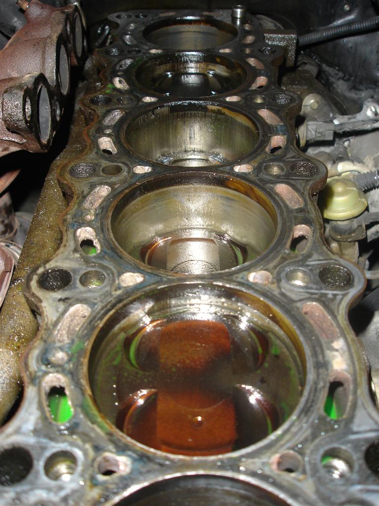

Engine Block - doesn't look too bad either. This was after the gasket scraping, I still have a little bit of work left but wanted to let some seafoam/carb cleaner soak it overnight. The razor left some minor scraping, hopefully nothing too bad. I just dont want to push down too hard on it. BTW the coolant on the pistons is from the air compressor blowing it all over the engine (wonder who did that ). I cleaned it up later on

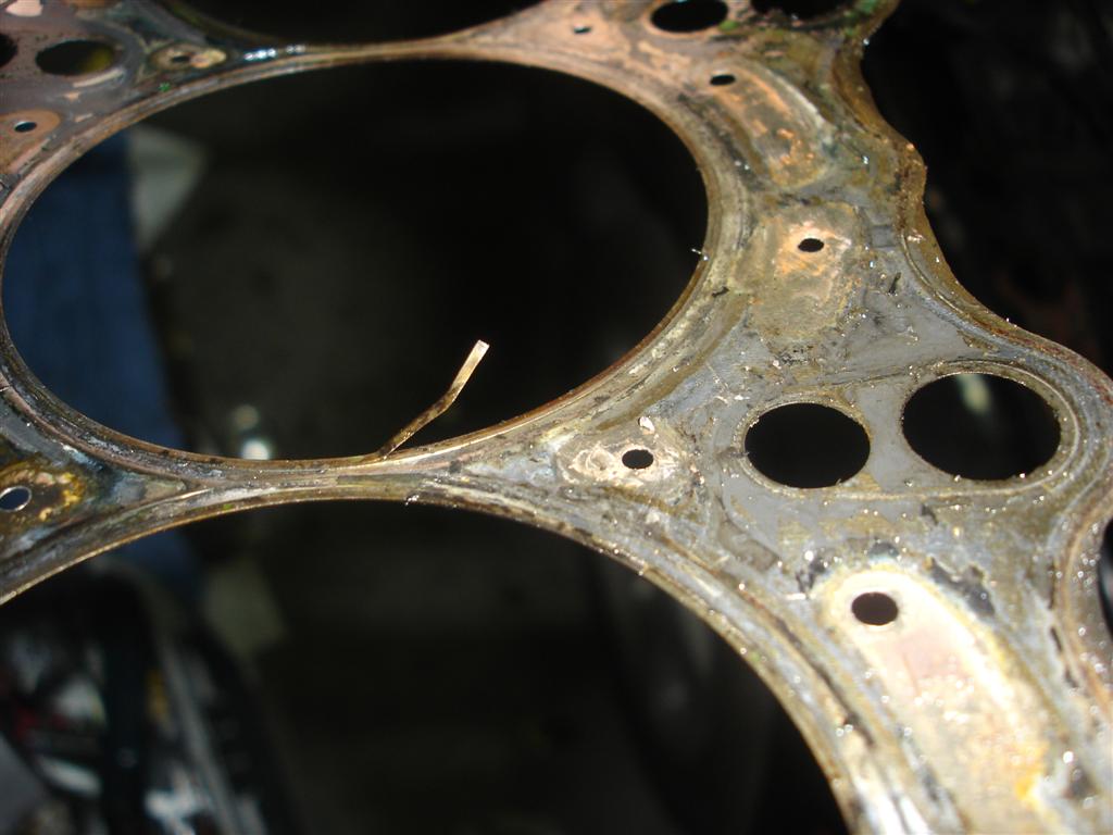

Here's where I think the headgasket blew on cylinder #2. There looks like there is a copper ring around each cylinder in the HG and this one was definately blown. I bent it up so you could see it easier, it wasn't like that to start with!!

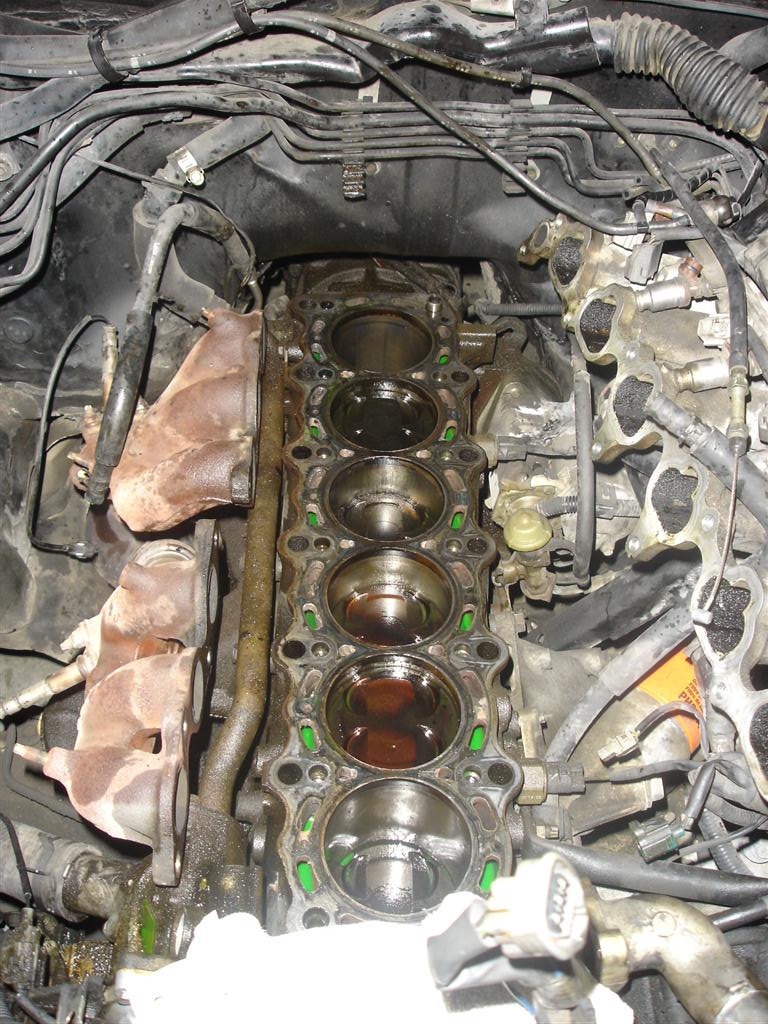

Another shot of my engine block and engine bay. Look how dirty it is. I'll be getting in there with some carb cleaner tomorrow to get those intake pipes!

Wow thats one clean piston. BTW, your #4 cylinder wall looks a little rough (in general and compared to the others). BTW, if you want the head to be really clean, take it to a shop and pay them ~$50 to have it jet tanked, and simple green also cleans the stuff of pretty well. The carbon build up in the combustion chamber and exhaust ports is near impossible to get off with household cleaners though.
