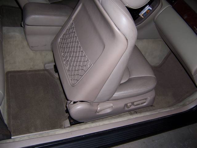

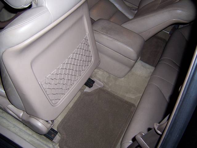

I know I saw a post earlier regarding this, but I cant find it. The netting on the back seat of my car is sagging a little bit. Does anyone know how to fix this or know where the post is regarding this. Thanks.

ok the easiest way is to take the seats out of the car, flip over the seat and you will see a few screws holding that backing on, take the screws off and the whole piece will slide off once you put the seat up right. when the seat is up right pull the backing upwards and out don’t just try to yank it straight out, once its off from the back pull in the cord for the net and then just tie a knot where ever you want so it keeps the tension on the net.... hope that helps PM me if you need help

no need to take seats out if i remember correctly. there are two gold screws at the bottom that release the plastic cover. take a look!

Correct. I did this over the summer and there is no need to remove the seat. The screws at the bottom will allow the pocket to be removed. Just be very careful removing the molding that holds in the netting. Mine was secured with pressure clips and you need to work them off slowly in order not to break anything. Once off, re-tie the netting. I advise that you place the new knot so the netting is actually too tight. Mine "settled" a bit and sagged slightly. I had to go back in and redo.
