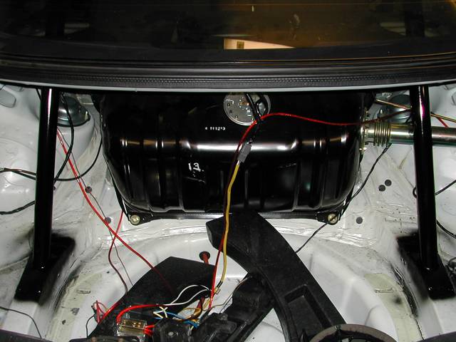

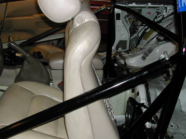

I also have a S&W cage in my SC (chromoly version) it's an 8pt. 6pt with 2 kicker bars. I would absolutely suggest not to go with a 10pt unless you are turning it into a drag car!
There is a great deal of work that goes into making that cage fit, like detuned mentioned. I have swingouts on mine, and was able to keep my rear seats, we put the rear bars through the speaker holes on the deck.
Factor in labor, a good welder will charge about a $100 per point to weld. There is also a ton of pounding on the flooring to get the plate to mate up on a nice flat surface. It's just not as easy as paying a couple hundred and having a cage in the car. It's not something that you cheap out on if you do it.
Here are a couple pics of mine
Chris

only ones I could find right now. I'll look for more later.

More pics of Chris' cage:
