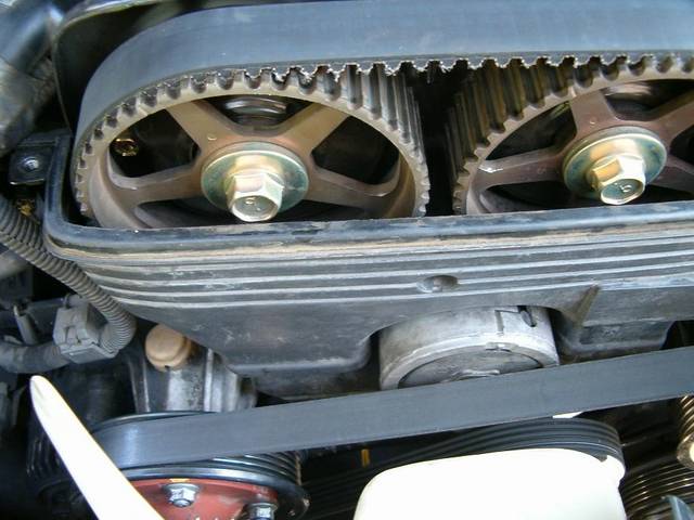

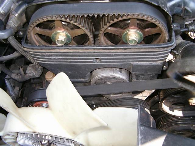

Ok pics time..
when yellow notch is aligned notches are 5 off counter clock wise from point of view facing car.
when white notch.. is at 0
it aligns. evenly.
Which notch is the right notch to go by? Does one notch = 2 degrees? ... which way is advanced and retarded again? (if you cant tell yet im a little dislexic when it comes to left and right.. damnit.
and for timing purposes which notch should I go by if I ever decide to use the gun?

It looks like you have everything lined up fine. Make sure the white notch on the crank pulley is aligned with the "0" on the timing cover and then the small notches on the cam pulleys line up with the notches in the back cover.
I heard others say the car won't run if you have either cam misaligned by even one tooth. Can't say what the deal is with your ticking noise, but as long as the belt is set you can rule out the valves. Are all of your pulleys ok? It might be a bearing on any one of the accesories or one of the tensioners.
Keep us posted.
