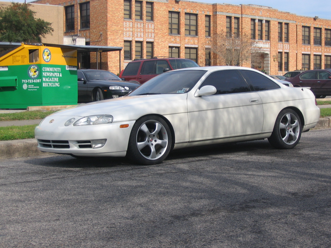

thats exactly what I was thinking too. The front will sit like that- the rear will sit a bit higher. Here is a picture of a car I intsalled this springs on last spring.
btw- The install time for this car was less than 1 hour and 45 min!!! (yes- I do indeed rock)
