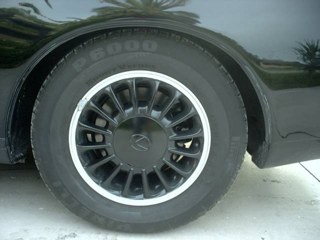

haha thats right. If you've got those 15" wagon wheels, then go out and buy some Dupli-color high temp (500 degree) high gloss engine paint, any color, pink, yellow, I dont care (black or gunmetal is always a good call). Then take off the wheels, clean em up with some degreaser/wheel cleaner, then take some medium grit sandpaper and sand em down some. If theres any curb rash, make sure to focus on those areas and smooth em out. Then wash em down, wipe them with some "Prep-all", or rubbing alcohol, whatever. Now, if you want the coveted lip look (haha), then grab some masking tape and carefully tape off the outer lip. Now all thats left is painting, and thats self explanatory. Heres the results

Those are 15" turbines you have there. Ive got the 16" wagon wheels. But definetly a great job on the painting. Im thinking of painting mine gunmetal.

Haha cost no more than $50??? This cost around $12 if I remember right. 2 cans of black and 1 or 2 cans of clear should do it. Ive had my rims like this for a few months and they still look just as good, this paint is very durable. Also, I did NOT paint the inside of my rims
