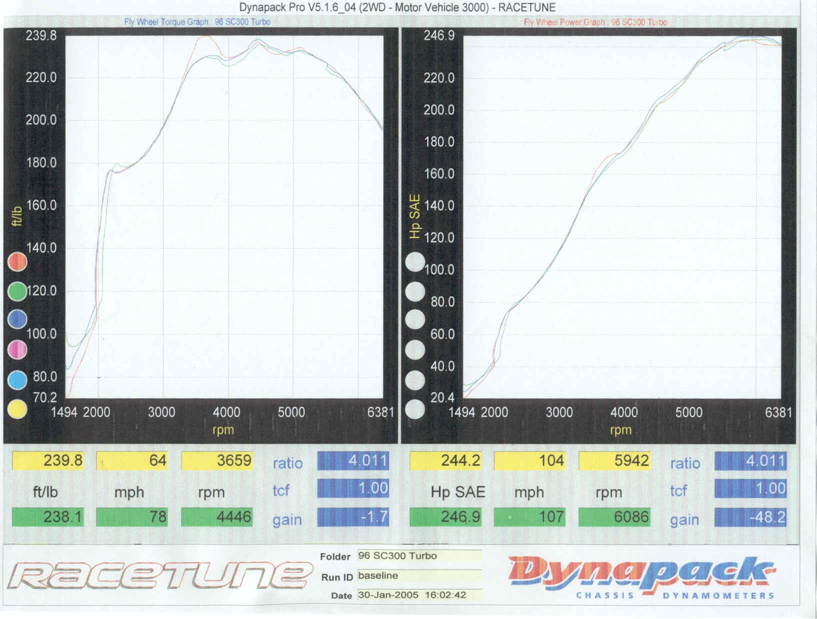

Finally made it to the dyno.
246.9 SAE rwhp and 238.1 torque @ 5psi of boost.
Not the typical insane dyno #s you see posted, but I'm just starting with this whole 'boost' concept and thought someone would be interested in seeing the streetable #s.

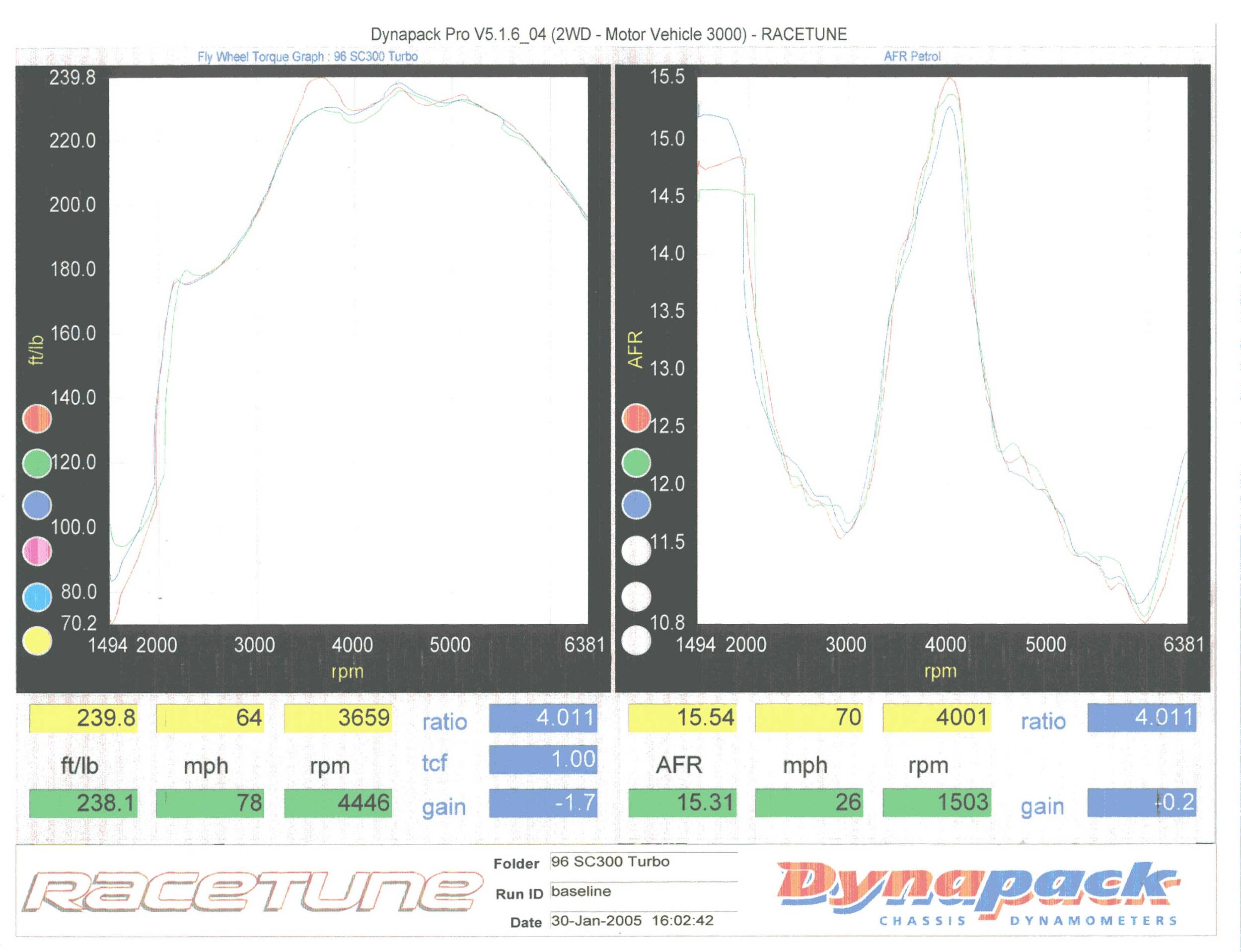

My OBDII ECU is still fighting my SAFC so the AFR at 4,000 RPM is definitely not something I like.

Thats more HP with 5 psi than I expected from the 2JZ..I thought 5 psi was going to get numbers like 220-230 at most...Nice start..

I did some rough calculations, and this is what I came up with:
Stock = 180 rwhp @ 14.7 psi (atmospheric pressure)
180rwhp/14.7psi = 12.25 rwhp/psi
Now the engine is crammed with 5 psi over stock for a grand total of 19.7psi (with the fuel to match after 4,000rpm )
12.25rwhp/psi * 19.7psi = 241.3 rwhp
Pretty dang close.
Using these calcs, I'd need 9.7 psi of boost to hit my 300 rwhp goal.
Cheers,
~Alan

I wish Gazi would chime in on that AFR spike @ 4K rpm.
Seems it's inherent to OBDII cars.
~Alan

I never dynoed. I suggest you look into the esc1 (made by spitsec). When the device sees positive boost, it will throw you car into open loop. I know a few is300 guys have used this to tune out the lean conditions.
Old Feb 2, 2005 | 10:40 AM

Thanks Gazi.
I called SplitSecond and they told me that the ESC1 wouldn't do me much good because the spike happens even at WOT where the ECU is already in Open Loop.
Look at the graph...it dips to 11.5 by 3000 RPM and then climbs to 15.5 at 4000 RPM.
ESC1 is used to get the ECU into Open Loop at partial throttle when there is positive boost.
When you had your kit, did you monitor AFR in any way?
~Alan

so obd2 gets lean at 4000 rpm? did you find out how to richen that area yet?

I was only monitoring real time, not logging. At 4K rpm, have you tried riching it up alot?
Or does it not make a difference.

I tried the full +50% at 4,000 RPM and it didn't do squat.
As suggested by someone else with a similar issue, I'm gonna try richening it earlier (3500 RPM) and see what happens.
~Alan

With the AFR printout seen above, the only thing 10 psi would do for me is cost me a new engine.
I'm trying to resolve the AFR spike @ 4K RPM.
If I ever figure it out, I'm gonna turn up the boost to ~8psi and check the AFR again.
This whole unpredictable ECU thing is killing me.
I even though about purchasing an AEM EMS but then realized that would just add unknown variables to problems I already have.
I'll figure it out someday.
I already solved a few problems such as the post-blow-off stallout, so I'm sure I'll find an answer for the lean spike as well.

before going aem, pop in a obd1 ecu, that may do it for ya.
