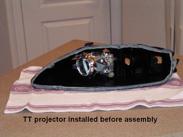

Here is the reason I sold my High quality Phillips HID's. The rest of the pics to come when I am finished with the project...

Actually, that is not the lens, but a plastic bag around the projector. I want to keep the fingerprints and dust off of the projectors until I install them in the assembly. I thought about clearing the lens of the ridges, but I am thinking that I will leave them alone...

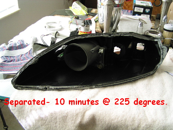

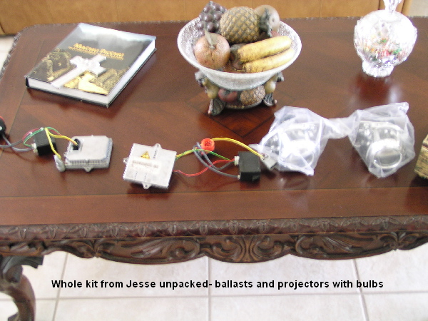

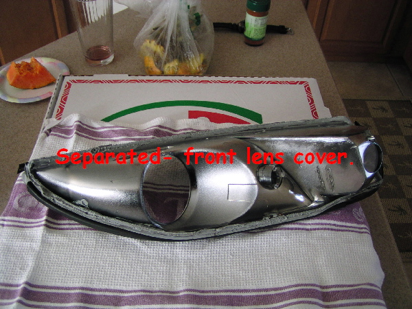

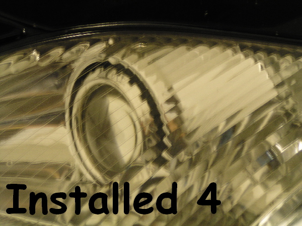

OK Gang, Here is the rest of the install of the Audi HID Kit I bought from Jesse...Looks great, spent all weekend installing this one
Ryan
[img}https://www.clublexus.com/gallery/da...eadlight_1.jpg[/img]

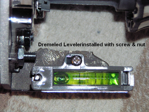

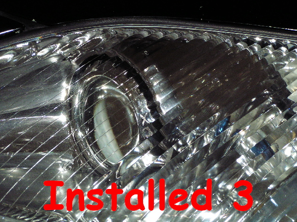

More of the install...

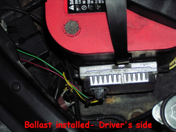

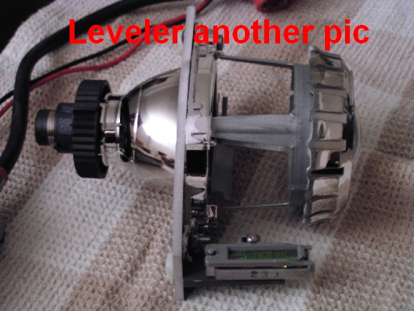

Last of the install!!!

this audi TT/xenon cover is one of the cleanest fits in the SC...looks completely stock!
just wait till you break in those HID's ryan, they'll look as blue as mine
Great job on the install...easier than you thought huh?
