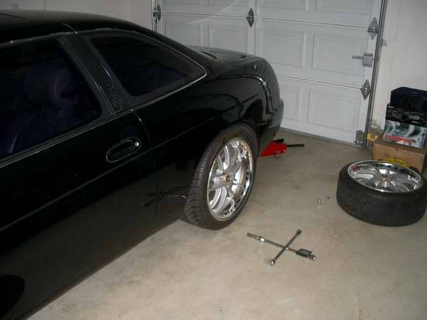

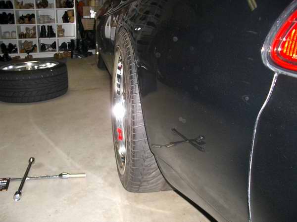

Like this one ;-)
I love the meisters... I had them on my car for a good 10 minutes. Borrowed them off my friend's supra. The offset fit on his car, but not on mine!

John, How strange! I bought my Work Meisters from a Supra owner and they fit perfectly. I'll try to find the offsets, but the rears are 18x10" and the fronts are 18x9".

You should be fine with the standard supra offset. On a 10" rear you'll need a +45 offset. On a 9" front you need a +41 offset. Hi disk if youre running supra tt brakes. My friend wanted a fat lip so he got some crazy offset on his car.
