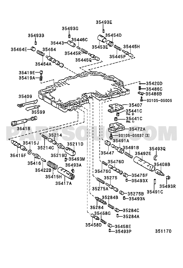

If you want to troubleshoot this solenoid here 9033905014 PLUG (FOR 1-2 SHIFT VALVE) 35464A and 35454D both are for shifts 1-2. Both are on the left hand side of the image. D is at the top, A is towards the middle. Troubleshoot those 2 and you will probably solve your shifting in and out of 2. Odds are D is probably gone, but can't know without jumping terminals.
VALVE BODY & OIL STRAINER (ATM) | Toyota SOARER UZZ31-ACPZK JZZ3#,UZZ3# | Parts Catalogs | PartSouq
My only issue with that is that a performance shop in town replaced all of that under the previous owner.
