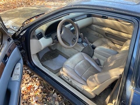

Wednesday the 13th I picked up a 1992 SC300 with 216k on the dash non running for $1800.
She’s a Royal Indigo Pearl on tan with an auto and I believe it’s a cali emissions car.

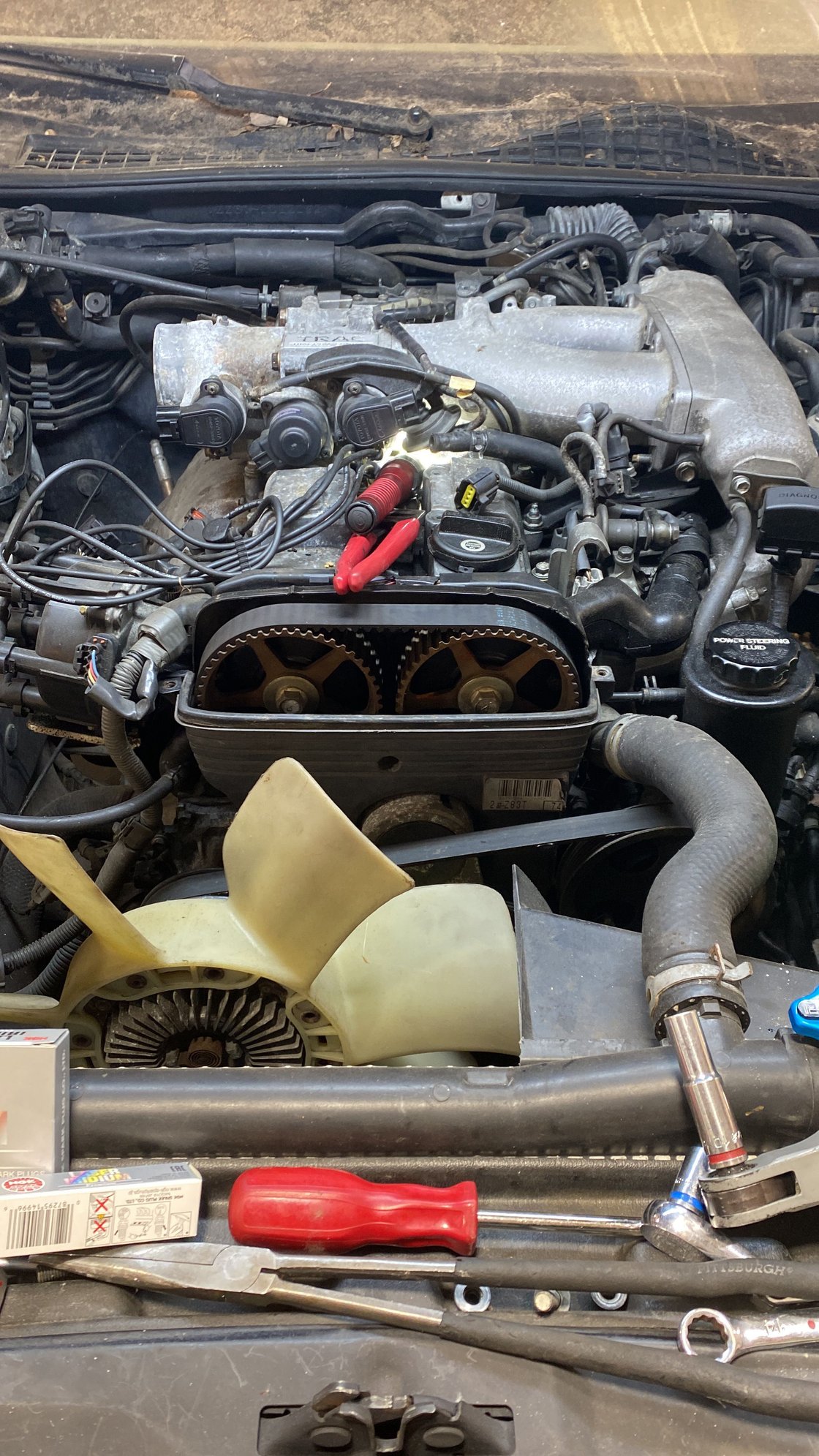

I spend the day working on it, diagnosing a few things. It has been sitting for 6 years so I put 5 gallons of 93 in, replaced the vacuum lines that had blown out while the intake was off, and gave it double iridium plugs because that’s all any of the stores around had 😭

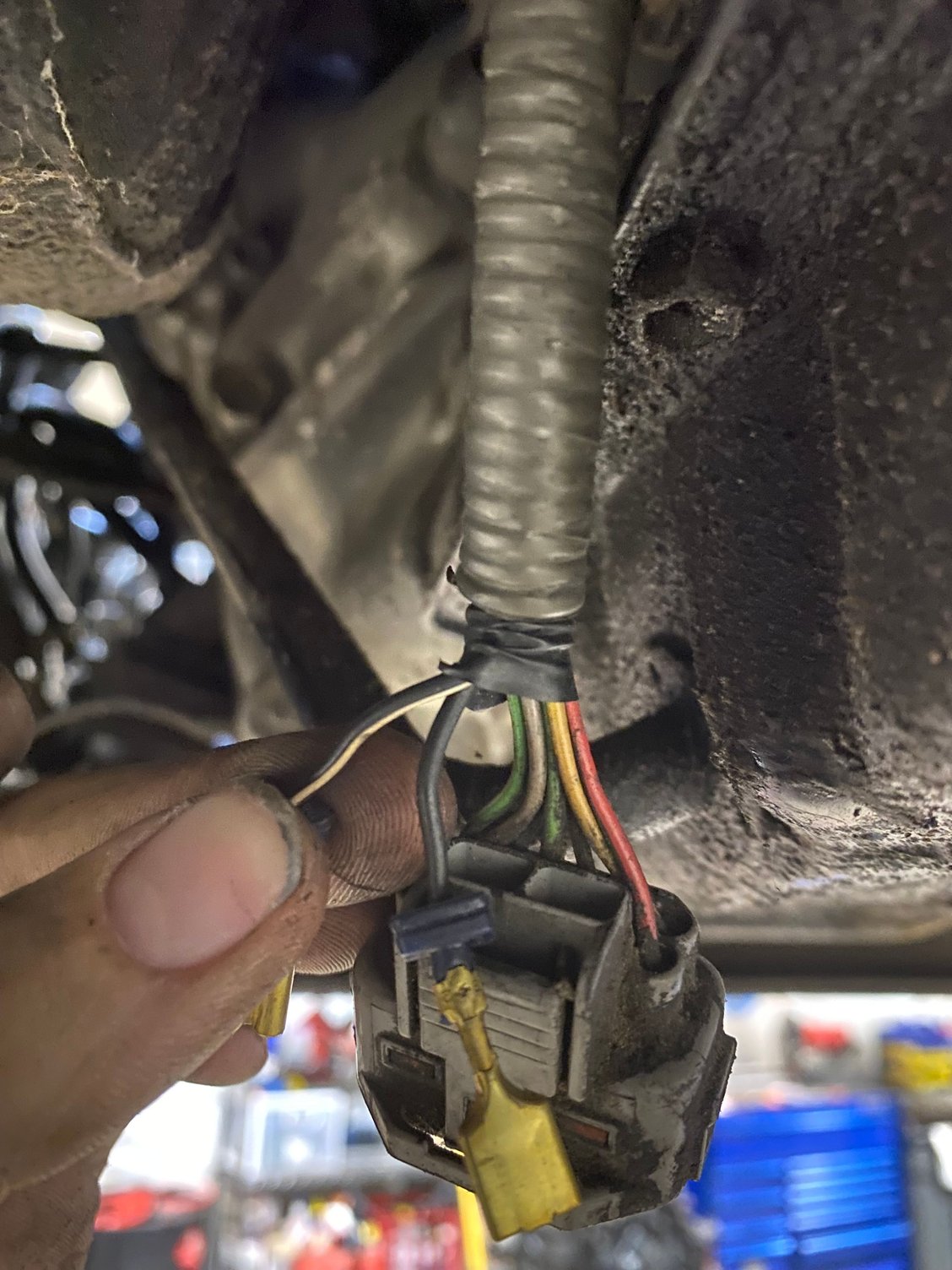

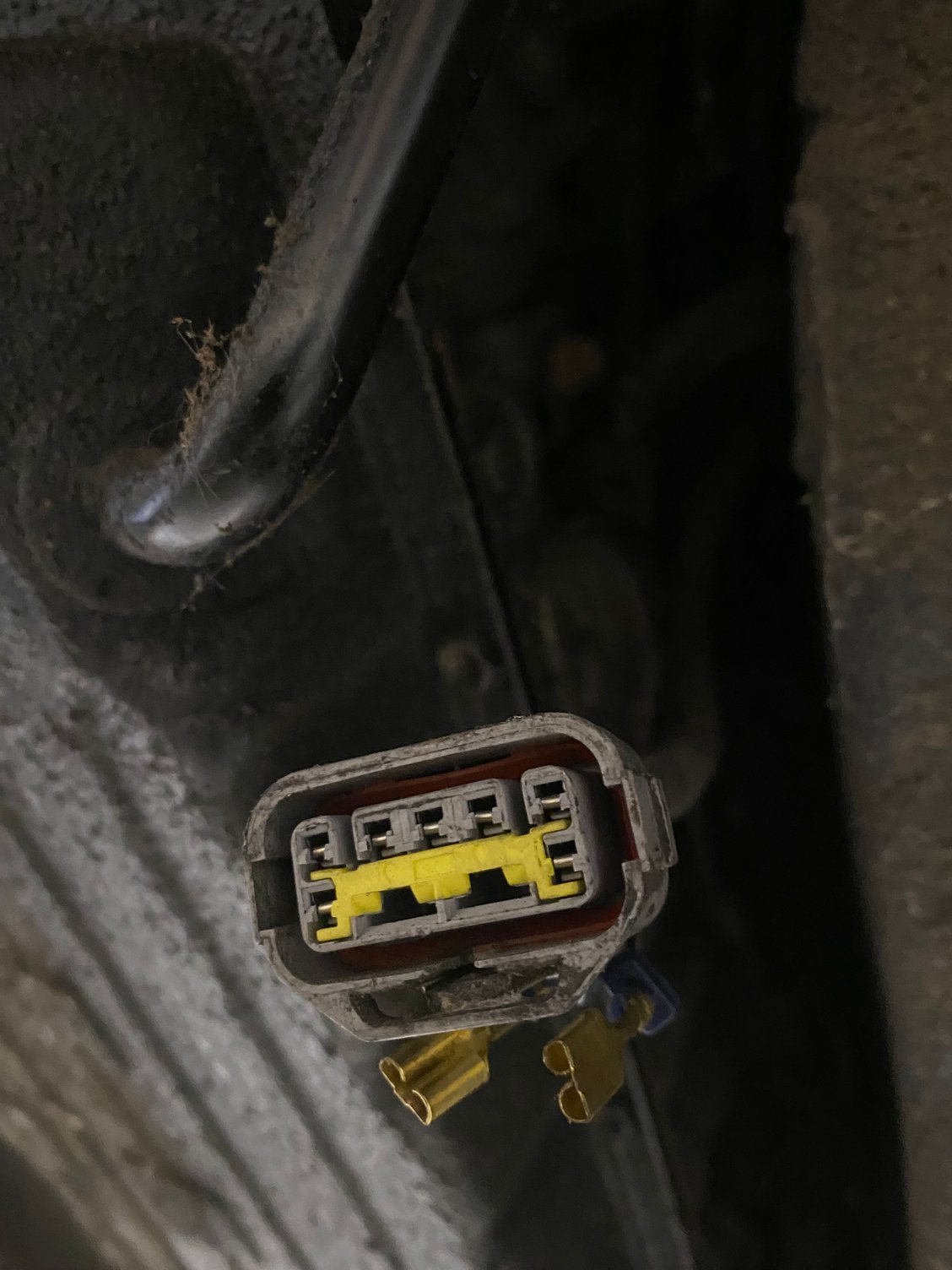

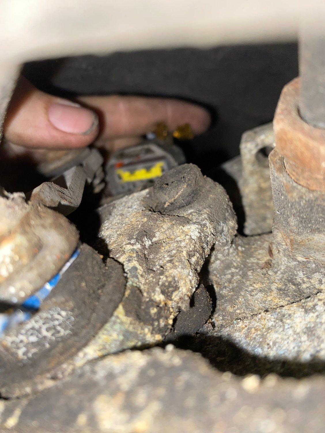

Jump box on, key on, no ignition. Thanks to a post on this forum I saw that the dash lights remained on while the radio and climate control went out on key ignition. This means the neutral safety switch wasn’t sending signal to the ECU. Quick depin and snip of wire 2 and 3, solder, and a little heart shrink to permanently loop the switch in preparation for the eventual manual swap.
Ignition works with key; time to get some fresh fuel up in the lines. After that it starts first go and catches idle just fine. Come to find out it needs an alternator and my power steering pump leaks like a siv. If anybody has these in perfect working condition hit me up please.

Location of Neutral Safety Switch
Close up
Closer
These two, pin 2 & 3, black and white wire + solid black wire, solder, heat shrink, tuck into harness
