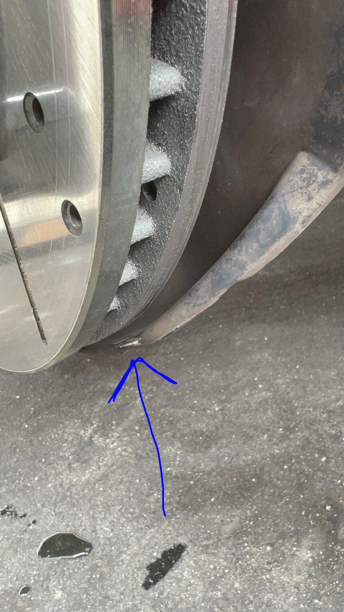

ISSUE RESOLVED!
hey thank you for taking your time to respond to my question. I found what was causing the grinding noise. Turns out it had noting to do with the brake or calipers. It was the dust cover that sits behind the rotors. It was rubbing against the bottom of the rotors. When I was jacking up the control arms to keep a support on the rotors I accidentally pinched the dust cover and ended up bending it. Lucky all I had to do was use a pliers and bend it back. Glad I didn’t have any brake related issue.
