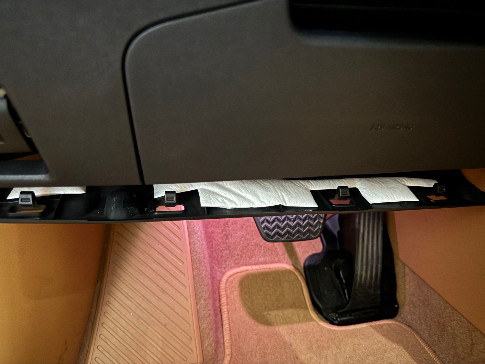

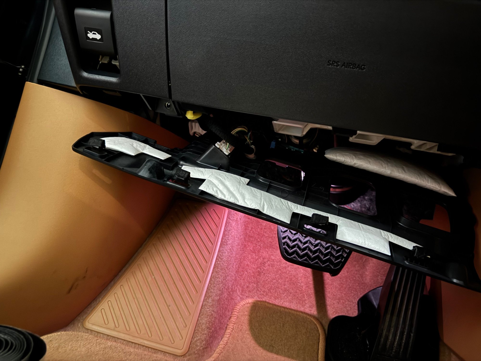

Finally, with regards to rattles and noises. I found the same dash rattle came from this plastic panel under the drivers footwell. During warmer days the plastic softens and when you drive over bumps it makes a noise and sounds like it’s coming from the HUD area. I put some felt strips at the contact points the eliminated the noise.
