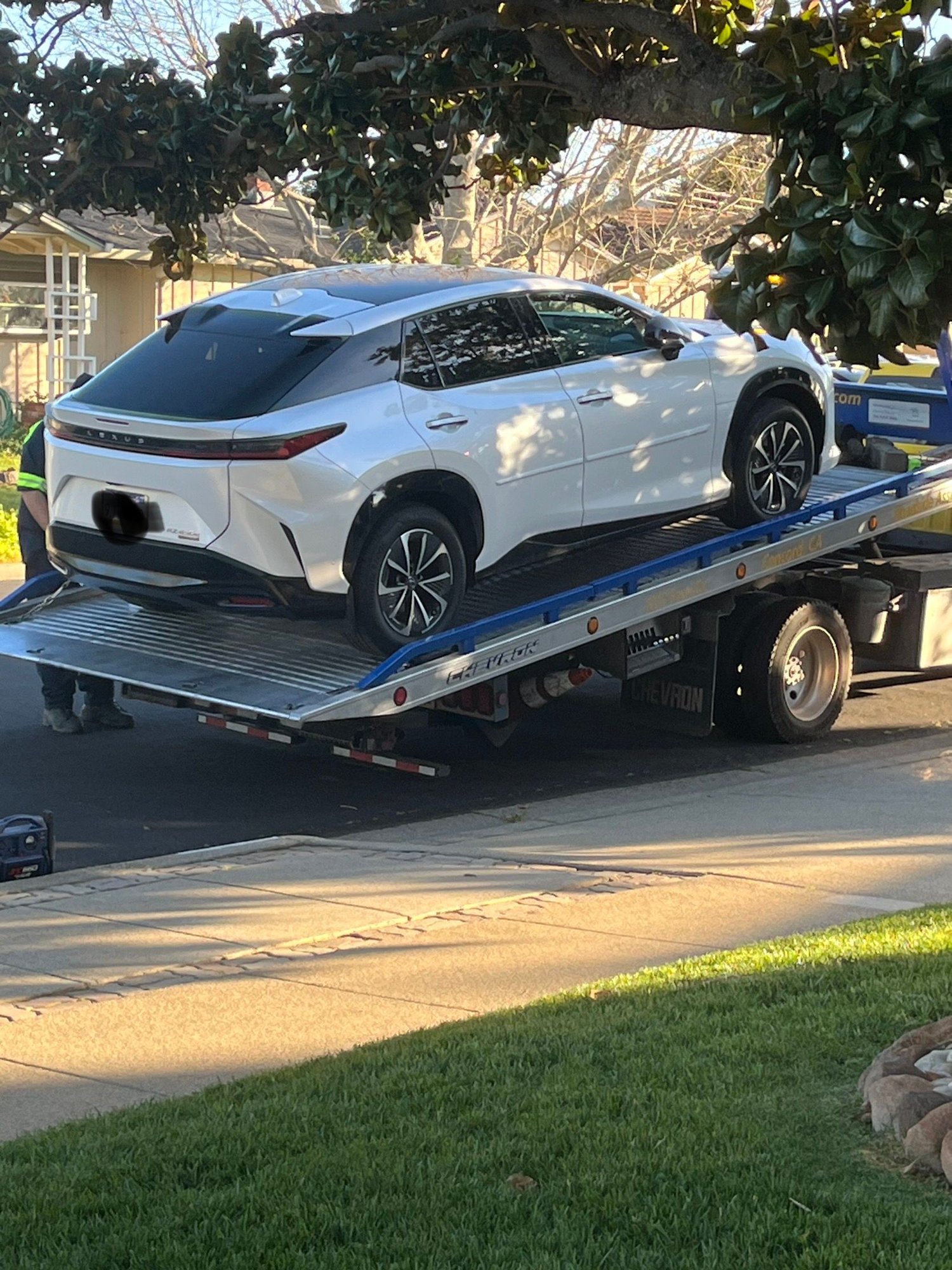

And the 12V battery saga continues. Have had three 12V battery failures in the course of less than a month; the car has been in the shop twice for this; and they now have had my car for 2+ weeks with no resolution in sight. The dealer’s service advisor said they have reached out to Lexus Technical Assistance for help…. but there still isn’t a solution. I’ve told them about the same issue some Toyota BZ4X and Subaru Soltera owners have had, and I even sent them the YouTube video I posted in a previous post about this happening to a Toyota in June 2023 … but they still haven’t resolved this. From what I understand, they’ve known about this for at least a year or more. It’s all very-very frustrating.

Sadly, the RZ remains in the shop … we’re now at day #25 … with no fix in sight. No one seems to know why there is such a big drain on the 12V battery or how to correct it. My frustration with this is through the roof since this has been a known problem (from what I read on line) for at least one year, or longer.
Here’s link to a YouTube video in which a Toyota BZ4X experienced the same problem in June 2023. And I’ve read on other forums that several other RZ owners have experience the same.
