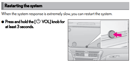

I haven’t experienced this issue before. If turning the RX off and restarting it resolves the problem, next time you can try pressing and holding the volume **** 3+ seconds. This will reboot the infotainment system without turning the vehicle off and on.

I haven't tried it yet, but I think it will not reset any settings. On 2026 rx350h's multimedia owner's manual, page 15. It says "Restarting the system: When the system response is extremely slow, you can restart the system. Press and hold the [VOL] **** for at least 3 seconds."

most of the time holding the volume and rebooting fixes nothing .
you often have to wait for the car to reset which can take some time . maybe 20 minutes or so

Holding down the volume button for three seconds just reboots the system and keeps all your settings. We both have to do this maybe 5% of the time if we don't connect to Android Auto. One time my wife's NX 2023 had the Hawaiian time thing. Might have been Hawaiian time but not their temperature.
