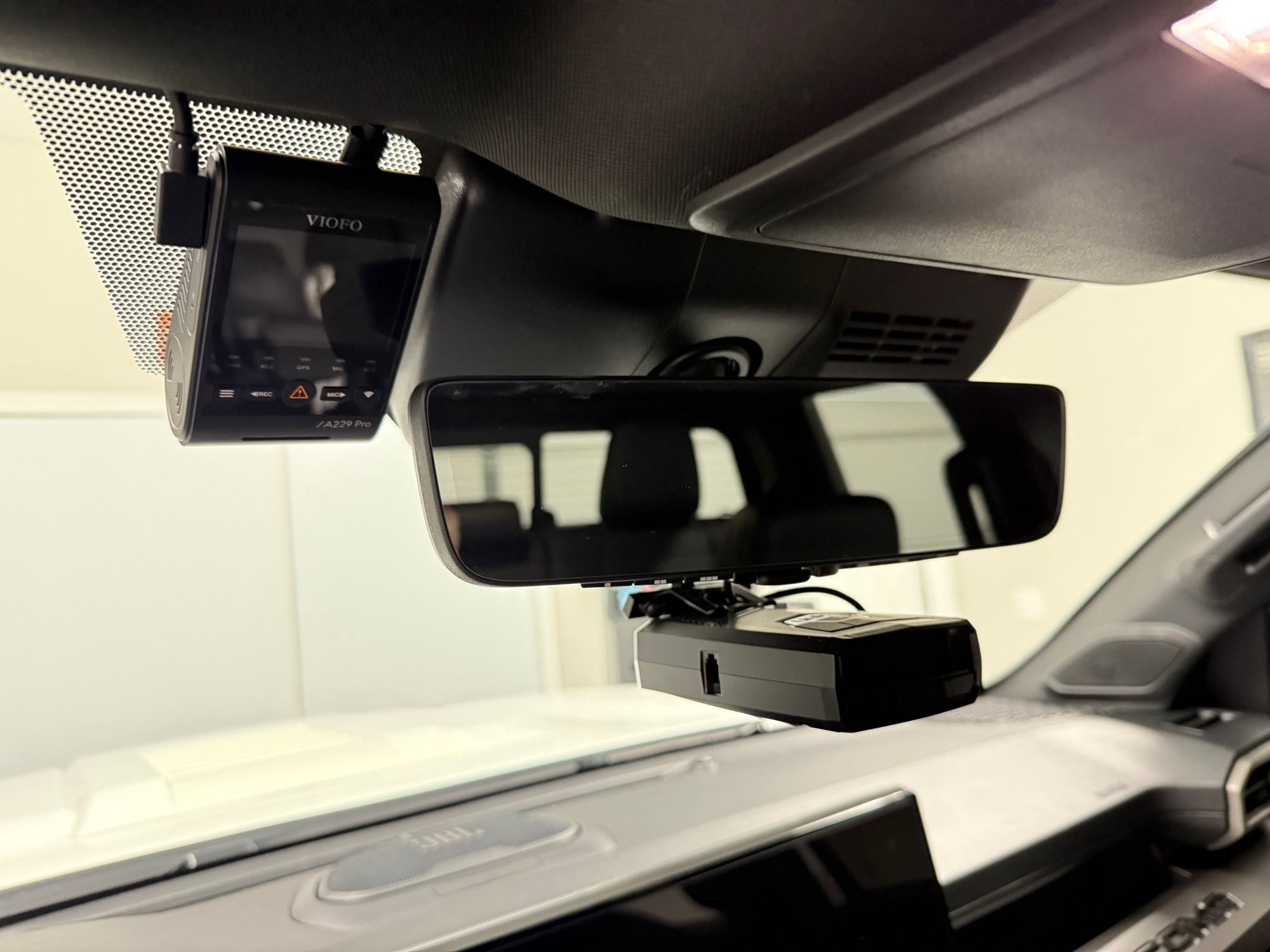

here is the dealer installed lexus dash cam , and my uniden r8 radar detector hard wired to the fuse box .
the mount for the uniden is the suction cup which grabs the mirror housing very well

RE: "the mount for the uniden is the suction cup which grabs the mirror housing very wel"
Do you or have you ever had the suction cup come loose from the mounting spot on the plastic that it is on or do you have a magic secret to keep it from eventually falling?l
Old Nov 29, 2025 | 12:43 AM
mathjak107's Avatar
mathjak107
Joined: Jul 2023
Posts: 271
Likes: 81
From: ny
i just stuck it on once to that plastic base for the mirror and it has never come off , at least not yet because i said this. lol
