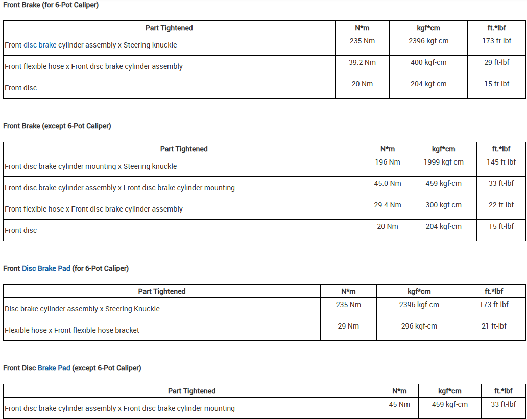

Does anyone have the torque specs for the brake mounting bracket and slide pin? I think I got a rock stuck in the pad and it's making a perfect circle on the rotor. Trying to remove it and clear the debris. It's a 450h+ if that makes a difference.

tammap's Avatar
tammap
Joined: May 2007
Posts: 811
Likes: 361
Old Jan 1, 2025 | 04:56 AM
sheepoo's Avatar
sheepoo
10th Gear
Joined: Sep 2015
Posts: 10
From: Ontario
Thank you @tammap .

Hi, Tammap, Do you have the brake torque specs and service diagrams for 2025 RX350h? I wonder if the caliper bracket bolts are one-time-use. Thanks!
