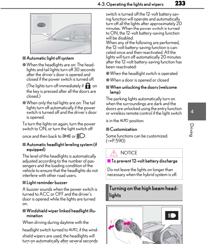

[QUOTE=tammap;11840696]@DEL92 Happy New Year!
Tammap, I appreciate your follow-up with the page number in the manual. Have a Happy New Year. Del92

Originally Posted by DEL92
We drive a 2023 Lexus Rx350h.
When the windshield wipers are in auto mode, and the sensor activates the wipers, do the headlights also turn on?
In California, the laws require us to have the headlights on if we are driving with the wipers on.
thanks in advance.
The law is not exactly as you stated. The law states if wipers are in continuous use, such as due to rain or inclement weather which is defined as:
“A condition requiring the windshield wipers to be in continuous use due to rain, mist, snow, fog or other precipitation or atmospheric moisture.”
If it is dark enough the lights will turn on regardless.
In either case this is a non-issue as the operative word is “continuous.”
