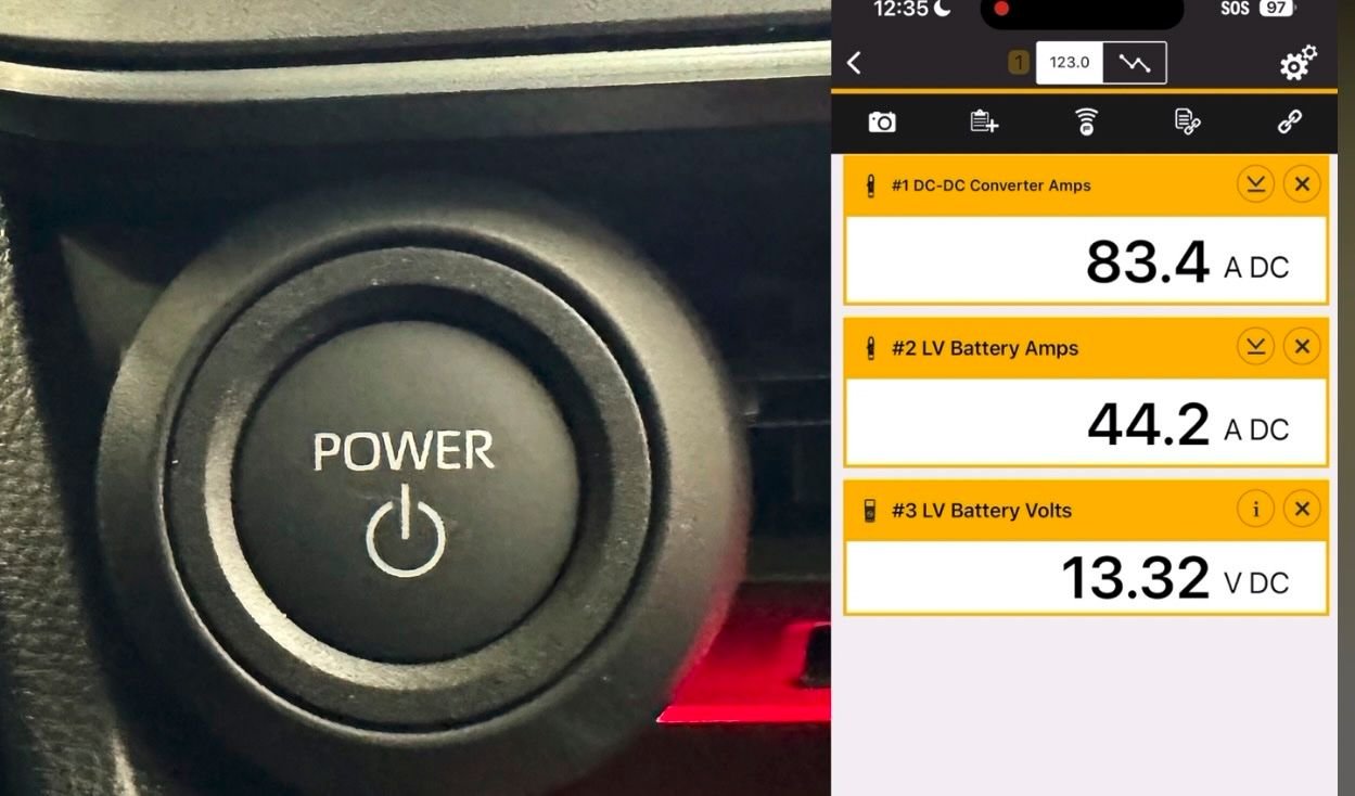

ACC mode = 25-30 amps
Following include ACC amps
Headlights on = 40-45 amps
Heated steering wheel or seat = 34 amps
HVAC = 36 amps
Immediately after starting, I observed a 12v charging current of 56 amps, which tapered down quickly. The video below sees 46 amps charging current, tapering quickly.
Yes, referring to this exact point in time in the screenshot below.
This is obviously with a perfectly functioning 12 Battery in this Prius. This would indicate that the total current flow out of the (perhaps miserly, relative to Lexus) Prius' DC-DC converter at the point of turning the car on is actually 84 Amps at the very least. Now if the 12 V battery were degraded or nearly dead with having 0 - 3 V in a dead car - such that the 12V battery acts as a bigger current sink than the 44 Amps its drawing in the screenshot - one can easily see how the value of current draw out of the external cable easily try to go above 44 Amps for a few seconds. Now add on the fact that Lexus very likely has a higher electrical load than a Prius at starting, may have fan/heat/etc on, its easy to see how the draw can be far higher than 100 Amps for a few seconds.
Also, the car may actually try to draw higher than normal current from the DC-DC converter during that in-rush period as well (in the absence of actual jump-starter-source of current - which provides very high Amps for a few seconds), potentially damaging the DC-DC converter in the process. Seems like a very bad idea to even try.

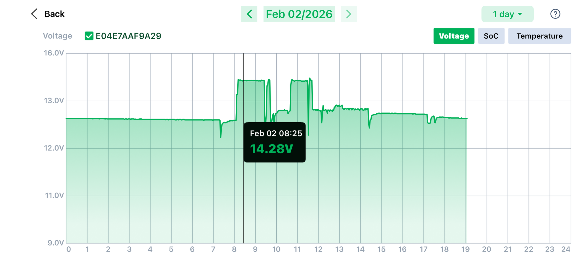

My RX450h+ seems to be charging the battery at 14.28 volts the entire time I am driving the vehicle. I believe this behavior is new but maybe I am confused.
If you look at the chart below you can see when I left my home at 8:09am and drove until 9:25am. The dip is when I stopped for coffee and then drove a short distance to my final location. You also can see at 10:41am that I began my drive back home until stopping for gas at 11:31am then drove home after that. It appears that the entire time that I was actually driving the vehicle the battery was getting charged like an old school alternator.

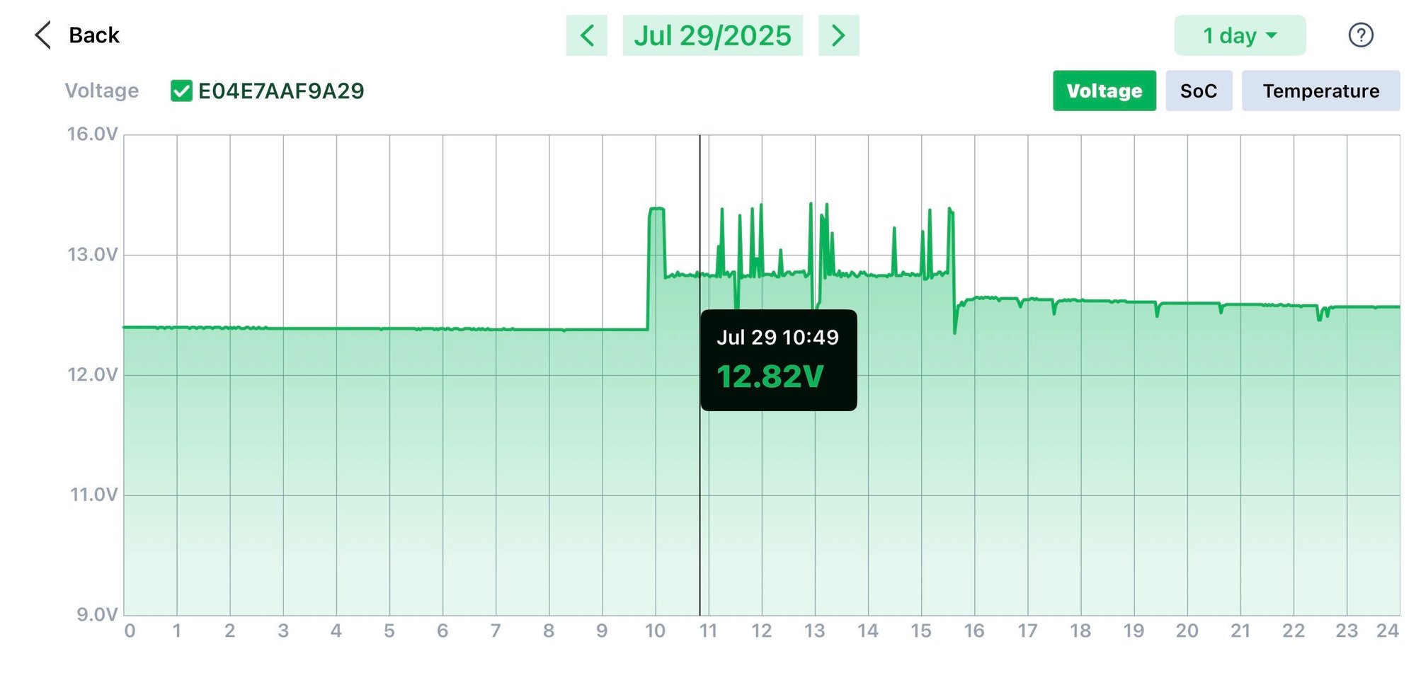

For comparison, here is a graph of a road trip from July. It shows a short charging session at 14.17 volts then the usual 12.8 volts for the remainder of the trip with occasional short peaks.
The one thing that I just read was that having your headlights on will force the 14 volt charging. My drive yesterday was in the middle of the day with the headlights on Auto so I don't know if they were on or not. It was maybe partly cloudy...
