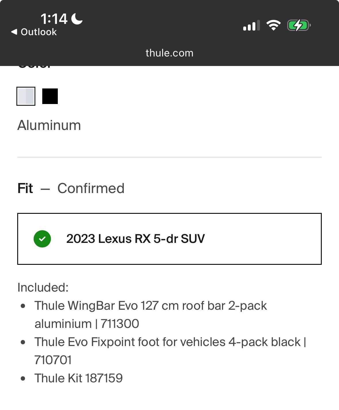

I can confirm that the Thule rack system works with a panoramic roof and flush rails. I have a 2023 RX350H premium+, and my rack system consists of the following 3 components:
Wingbar Evo cross bars 127cm. or 50" #711300 (black or silver)
Evo Fixpoint feet 4-pack #710701
Fixpoint Fit KIt #187159
Retail price is approx. $659
I installed the rack recently, but I have yet to use it with my kayaks. Each Thule foot attaches to the vehicle with only a single bolt provided in the kit, so that appears to be the weakest part of the system. I travel at highway speeds with long sea kayaks and there is a lot of crosswind force on the boats. The boats are lightweight, but bow and stern tie downs will be a must. I already have Thule kayak saddles that will attach directly to the cross bars, but otherwise they and other accesories (e.g., cargo box, bike racks, etc.) are purchased separately from the above kit. I am hoping and trusting that the rack attachment system has been properly tested by both Thule and Lexus for strength. I would feel more confident from the start if each Thule foot attached to the Lexus roof with 2 bolts. But, as to the original concern for this thread, the Thule system clears the open pano roof by a few inches, something that apparently can't be done with the OEM Lexus cross bars.

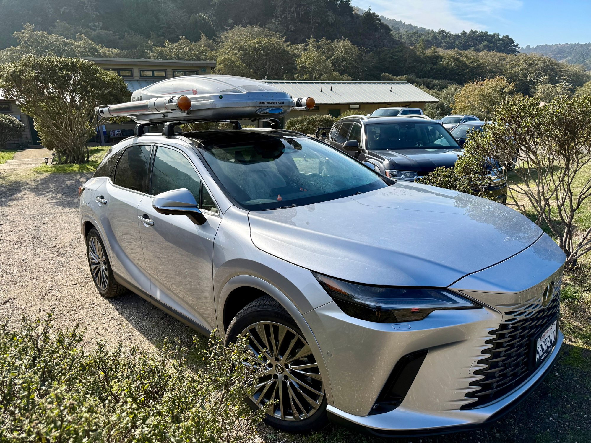

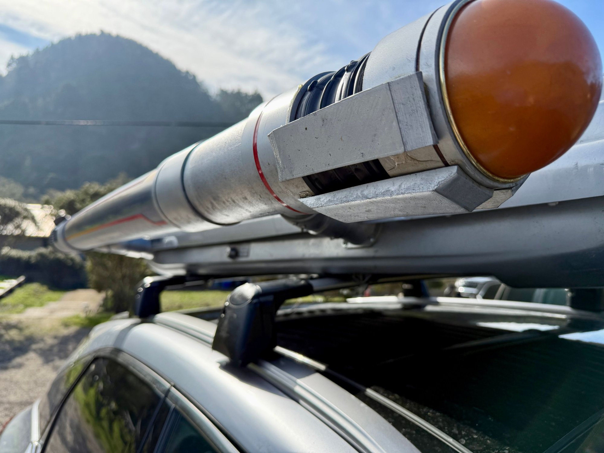

The theory about roof integrity sounds like supposition to me. What’s not supposition is that with Lexus’s own roof rack crossbars and most aftermarket ones, the panoramic glass, when fully open, will strike the rear roof bar. That’s why those of us who have roof bars with the panoramic glass roof look for ones that sit higher, like the Thule and the Rokiotoex.
I have done three significant road trips with a Federation shuttlecraft attached to my panoramic roof and I’ve had zero problems. The Rokiotoex crossbars are very thick and sit on the outside edge of the rails. They’re super sturdy, so it would seem to me they’re adding whatever integrity might be missing with the glass roof.
