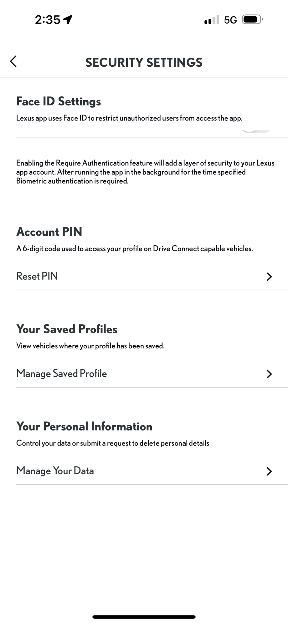

If you have the Lexus app on your phone you can reset the pin there.

The afternoon I picked up my car I tested everything I could think of before accepting the car except for 1 thing. The heat, specifically the drivers side dial. The heat was in the car already so the I turned it off as it was warm. I didn’t need the heat until the next morning and is when I noticed the dial was stuck at 80 degrees. The car was less than 12 hours old at this point. I returned to the dealership and they stated it was the controller behind the main screen, which of course they couldn’t get. I told them they needed to take it out of one the cars on the lot, which they did.
Sorry for the long story but when they installed the new controller it needed my pin which I had already forgot. They got their tech guru involved which he told me to reset through the app as I wasn’t getting the emails as well. Resetting through the app worked perfectly for my situation.
