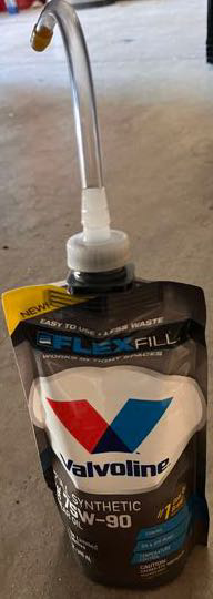

Quote: Did transfer case and rear diff today (car has 44K). I don't have a lift but I do have four car ramps and I needed every inch to clear the beer belly. Replaced fluid with Valvoline 75/90 full synthetic; in the squishy bags which are super convenient in dispensing the fluid. I added a short 3/8"ID clear tubing to the tip, then just squeeze the bag. As it empties, you can roll it up and turn it upside down as needed. Walmart has them for $12-$13 a bag, but I get the 3-pack from amazon since I use the same fluid in my Tacoma 4x4 (comes out to $11/qt). I used copper M17 crush washers for the drain plugs and re-used the fill-plug washers.
One thing to note: a little fluid came out of the transfer case fill-plug when I first removed it, but none came out of the diff, and it took more than came out.
Thanks for the vid Viktor.

Serviced TC and rear differential using valvoline 75w-90 squeeze bags. Also used small tubing attached to bag for TC fill. Fill plug is a bit of a PITA to get to on TC

Quote: Serviced TC and rear differential using valvoline 75w-90 squeeze bags. Also used small tubing attached to bag for TC fill. Fill plug is a bit of a PITA to get to on TC
Yup, same here. Also used the valvoline squeeze bags. It was kinda hard due to the angle.
