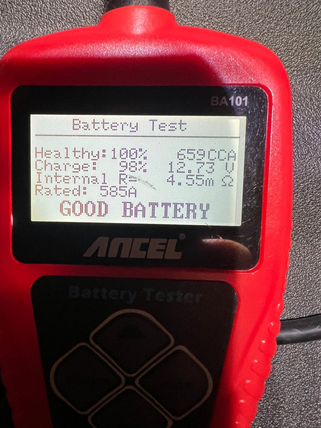

1) U should have tested the battery using a capacitance meter. It prevents u from purchasing a battery prematurely and wasting money. A tool and gut feeling is the best. Data center ie server farms use it for their UPS battery back- up systems.
My wife would have yelled at me for not testing before the trip. Lol
By the way, my 2021 Certified RX350 had a health rating of 67% upon the purchase. But after 3months of garage Batteryminder model 2012 maintenance charging, I was able to restore it to 100%.

Interesting point. I did test the battery in March using Topdon BT50 tester. As I recall it tested as GOOD with 60+% life. I also tested it after we got home and before swapping in the Duralast. It still showed GOOD and 50+% life. However, the next morning I tested it with the same tester, out of the car, and the status was REPLACE with 15% life. That reminded me that testing a battery soon after running the vehicle may result in erroneously optimistic health reading. The car started fine on the way home after a gas stop and the AutoZone stop, as I suspected it would. Even a worn-out battery will hold some residual charge for a short time.
For those asking about my choice to use an AGM, it was primarily for the lifespan, not the additional power. I swapped a 7-year-old AGM out of my wife's Honda Pilot this year even though it was still working fine. The Pilot has engine stop/start and requires an AGM. It's her daily driver and I did not want to risk a dead battery in it. (I keep a jump box in the Pilot, too. Having a jump box and getting her to use it in case of need are different concepts. ) My brother did the same thing with a dual-AGM setup in his diesel truck after 10 years. They were still operating fine, but 10 years felt like pushing luck.
Prior to attaching to the capacitance meter(CM) u need to create a load ie 30 sec headlights on to get a more accurate representation of the battery’s health. Unfortunately, the old school carbon resistor meter does a better job predicting remaining life but will surely kill a borderline battery of remaining life. It needs to be at certain voltage per applied resistance load to pass.
