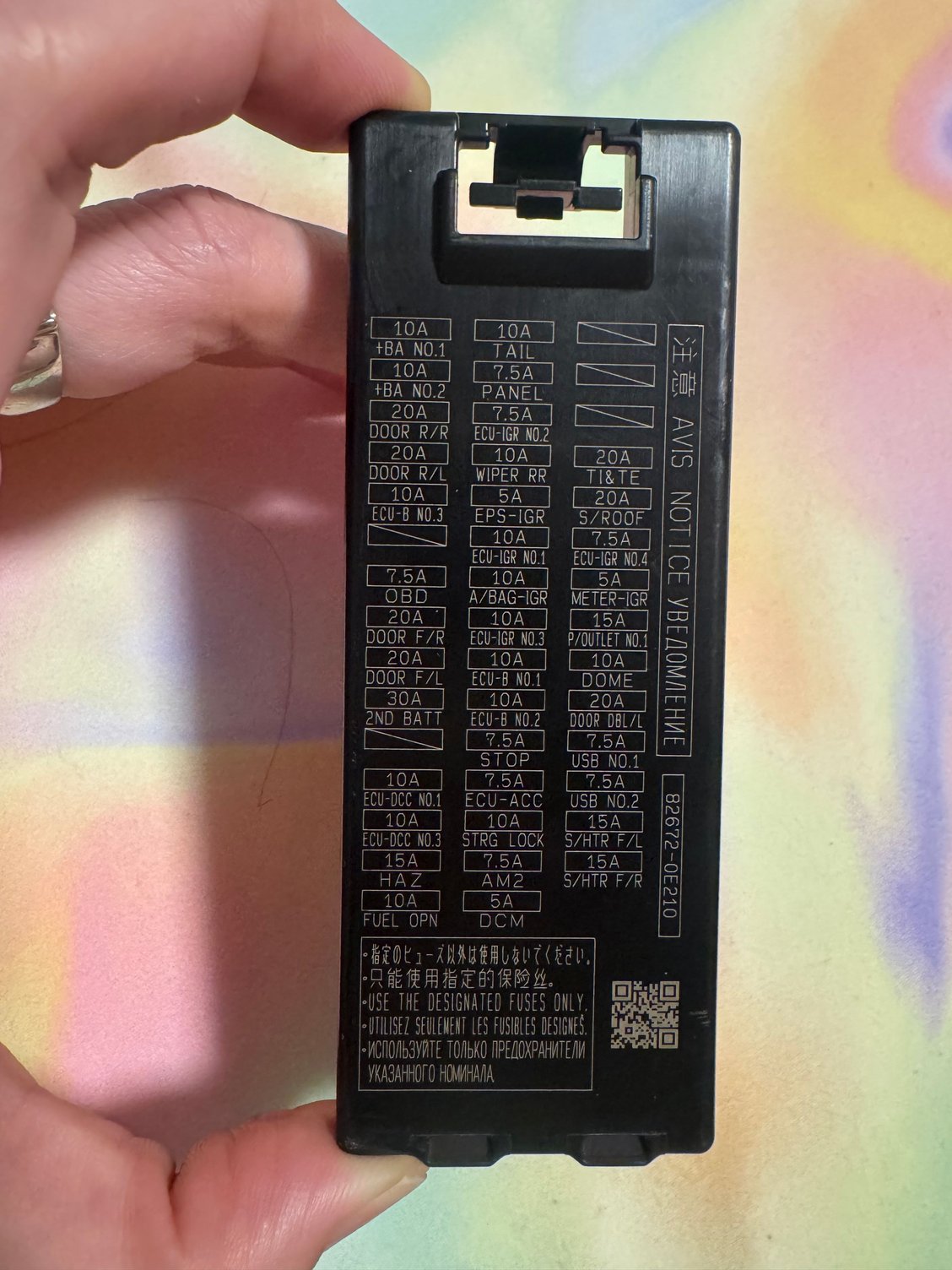

Old Nov 12, 2024 | 08:59 PM
  #40
Mimicute's Avatar
Mimicute
5th Gear
Joined: Nov 2024
Posts: 5
Originally Posted by dchar
Here you go...took off the cover when I installed a fuse tap for a dash cam.
anyone can suggest which fuse I plug in for ACC wire and which fuse for B+ wire ? I appreciated . My car lexus rx350 model 2024
Old Nov 12, 2024 | 09:31 PM
  #41
Mimicute's Avatar
Mimicute
5th Gear
Joined: Nov 2024
Posts: 5
Originally Posted by PotOdds
This YouTube was helpful.
How to Hardwire & Install VIOFO A118C Dashcam on a 2017 Lexus RX350 L,
Recommended using the 15A P/OUTLET NO.1 port.
15A P/Outlet No.1 for B+ wire ??
how about ACC wire? Thanks thousand times

5th Gear
Joined: Nov 2024
Posts: 5
Default Fuse Box locations
Originally Posted by ejisfun
[img alt="Is Hazard lights fuse 15A HAZ? For B+ wire
Power outlet No.1 15A P/Outlet no.1 ? For ACC wire
How can we check which one is B+ wire and which one is ACC wire when they’re both red color. I have same problem I can’t tell which one is ACC and B+ . So sorry for questioning 🤨 "]https://cimg0.ibsrv.net/gimg/www.clublexus.com-vbulletin/1290x1104/img_7798_6b291a802fce19e63eec235cb9eda760f7939229.jpeg[/img]
Is Hazard lights fuse 15A HAZ? For B+ wire Power outlet No.1 15A P/Outlet no.1 ? For ACC wire How can we check which one is B+ wire and which one is ACC wire when they’re both red color. I have same problem I can’t tell which one is ACC and B+ . So sorry for questioning 🤨
[img alt="My fuse box rx350 model 2024 .
Please give me advise for my dash cam wired installation. "]https://cimg2.ibsrv.net/gimg/www.clublexus.com-vbulletin/2000x1504/img_7762_c8c880b45b5df05b49fd50cd4c79b96448e49a0c.jpeg[/img]
My fuse box rx350 model 2024 . Please give me advise for my dash cam wired installation.
