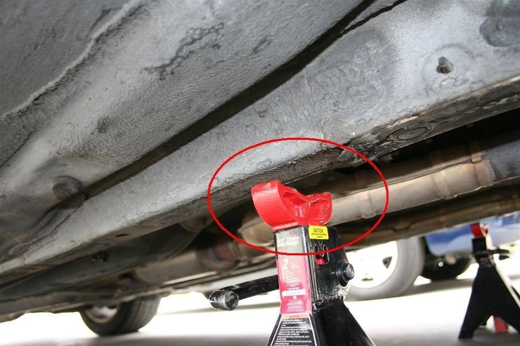

can you put jack stands on the frame rails?

what if we want to lift up just one side of the vehicle ? say to rotate driver front tire with driver rear.
Are these points okay to place stands? i want to know what other points are safe to place stands. Like differential, cross member etc.
Below: frame rail
Below: inside of pinch weld
Below: frame rail
I would not use any other jack points than the pinch welds and the center points, as documented in the owner's manual. I used the pinch welds when rotating my tires front->back, back-> front.
Below: frame rail
DO NOT use the frame rails, you will dent it. ONLY use the pinch welds. If you dent the frame, the integrity of the car will be compromised, and will not be safe to drive.
