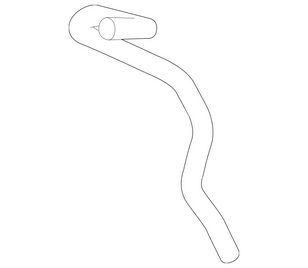

Replacement carpet is $1,000 silencer pad $600 they want $5,400 in labour? Damn. Here's why the drain clogs, the tube is long with a sharp bend this is an extremely stupid design.

I found this link but I guess you’d probably want to call your local Lexus dealer to see if they have it in stock or can be ordered.
https://www.bobbyrahallexusoflancast...prevention.htm
I can’t believe this isn’t added during production but even worse, $30 for that stupidity d let the king thing. I reckon that a small piece of net used on porch screen doors and a hose clamp would work just as well.
