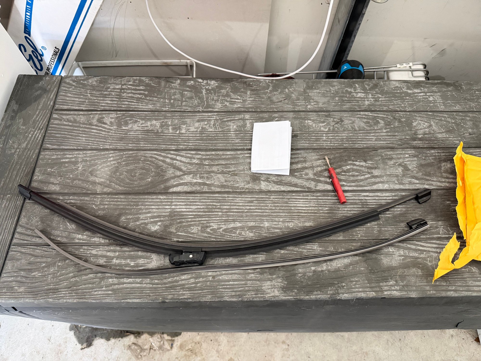

My wife has a 2019 RX350 and the passenger side wiper is falling apart. I was at the store and looked in the little book and it said that the 26 and 21 Rain X Endura Silicone blades would fit, so I grabbed those. I opened them up and the directions were a little confusing so I scanned the bar code that promised to link to installation instructions. On the page that opened it asked for the year model and make of the car for specific instructions and it informed me that they do not fit the 19 RX350. I then go to their main website and search for any blades that would fit this vehicle, and it said that they DO fit the car, but when you click on "installation instructions", it says that they don't. I finally figured out which adapter to use and they do seem to click into the arm on the car, but it allows about 3/16 of movement in and out. So I decided to return them.
When the wipers that are on the vehicle are removed, the clip shows a Lexus number, so I assumed they were OEM. So I go to my dealer to get the refill inserts (85223-0E011, and 85213-0E011). I get home and realize that these aren't a match for her RX350 as you can see from the pictures. So why do the Lexus wipers on my car not match with the refills and what other options do I have for wipers? Thanks

I called the parts department and the guy said the wiper blades that have replaceable inserts come on the vehicle from the factory. When those fail, you can either put in new refills or you can buy Lexus blades that have a rubber blade that isn't replaceable (they have the Lexus logo on them), and that was what was on my wife's car. So I was able to buy new blades with replaceable inserts (85212-0E081 and 85222-0E081) for about twice the price of the refills.

Yeah, I tried to do the same and those are the parts numbers I purchased for the inserts. But they wouldn't fit my Lexus wiper blades. The Lexus parts department told me that mine had been replaced with Lexus "one and done" wiper arms that do not have replaceable inserts. So I had to purchase new wiper blades. So that I now can use the refill inserts again. These part numbers are:
85212-0E081 (right side) which use refill 085213-0E011
and
85222-0E081 (left side) which use refill 085223-0E011

That is exactly how my new ones look now that I replaced the Lexus "one and done" blades with the same ones that came on the vehicle when new. My wife purchased this one used and apparently they had replaced the entire blade instead of just the refill. Now I have the correct original blades and a set of refills for when they go bad.
