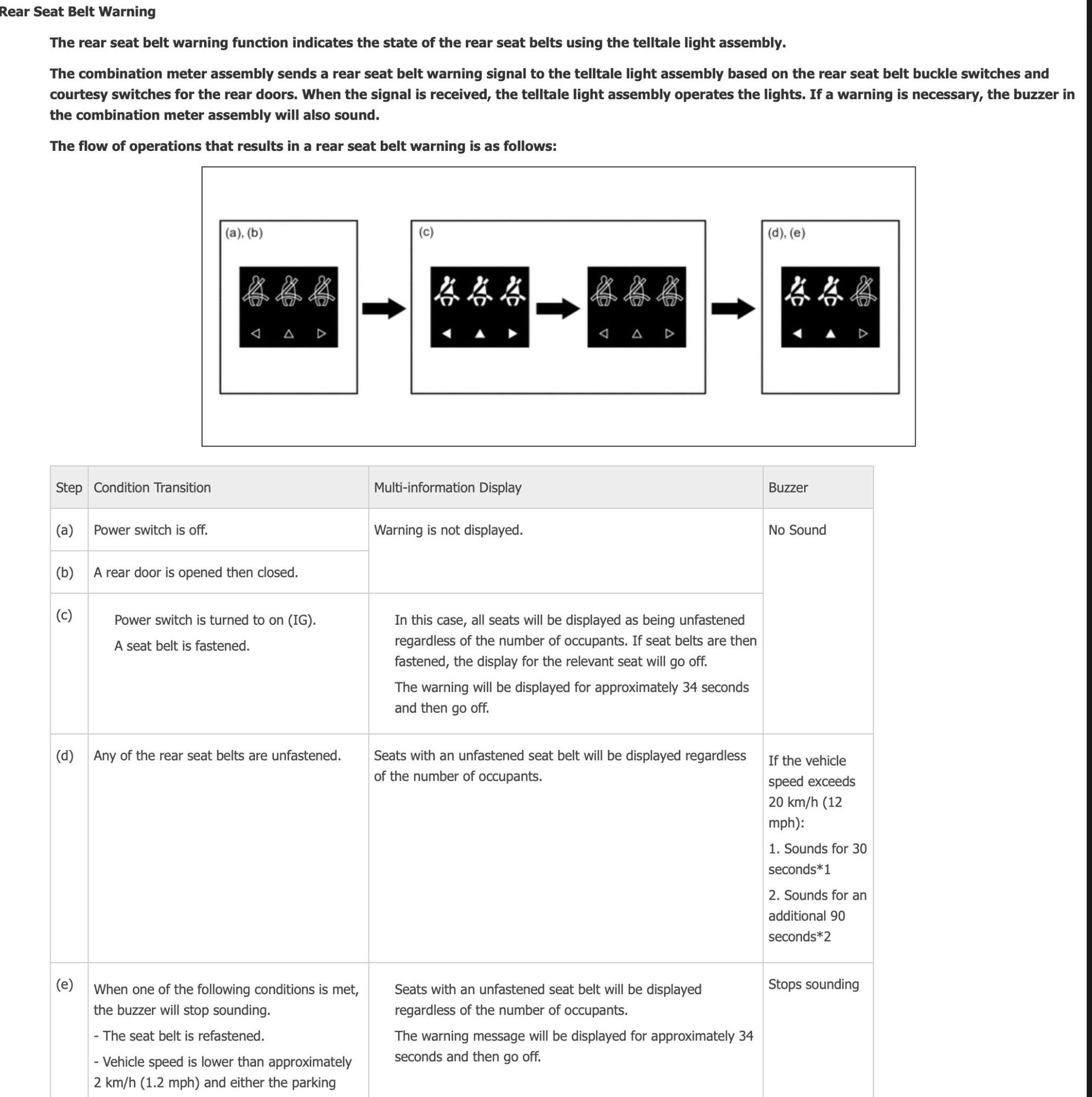

What is the below lighted image of three people and arrows? I haven't found it in the manual yet.

This is what I found online....not sure if it applies....

Seatbelt reminder. I disabled the seatbelt chime because it gets annoying when you place things on the seat.

It shows which of the rear seat belts are buckled. When red is unbuckled.
Only comes on if rear door was opened and only stays on for a bit.

Tattles on the kids.
