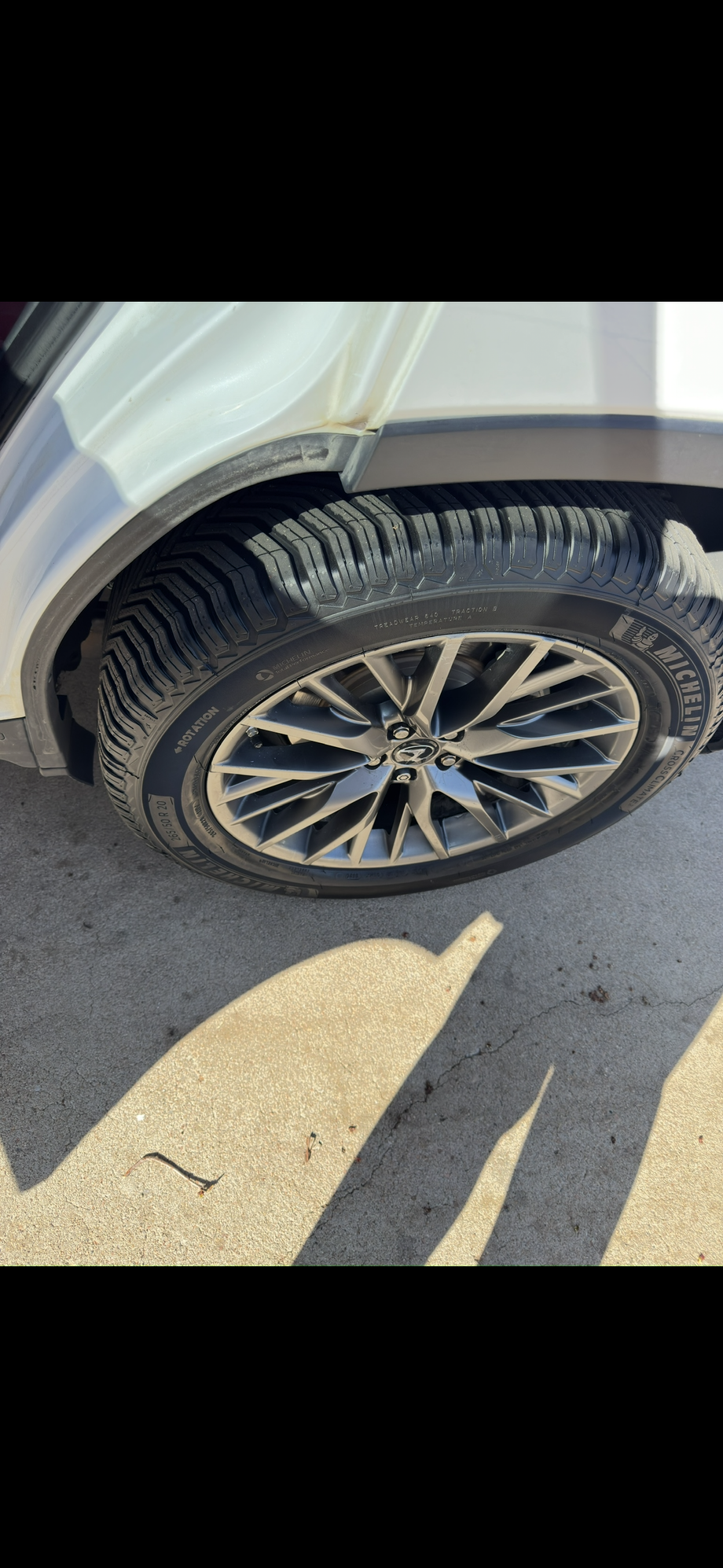

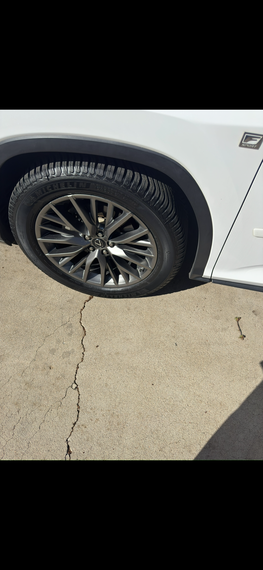

ok so dont get the cc2 in 265, everyone says they fit which they do but they rub slighty with the steering wheel full locked and also going over massive bumps that make the rear suspension squat. Crazy how no one mentioned this
go with the 255’s
