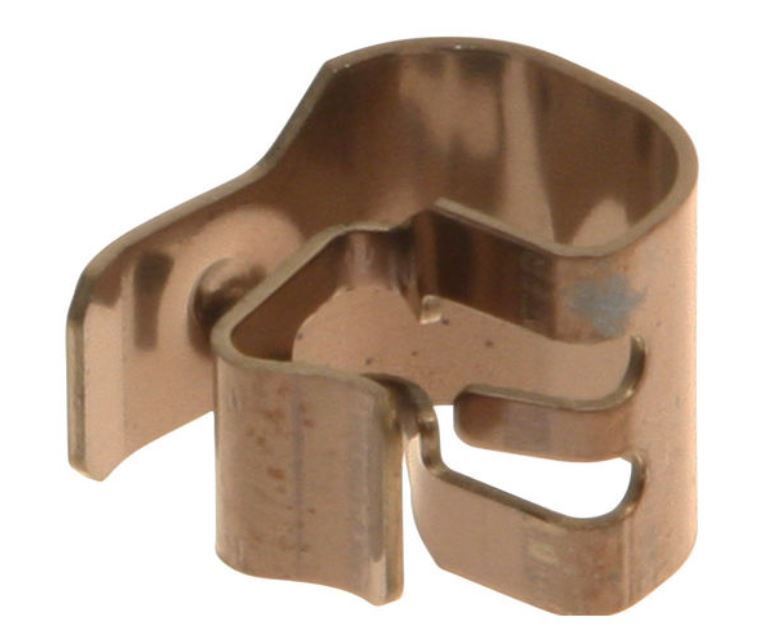

There is a brake pad wear sensor that will start to "squeal" when the pads are close to needing replacement. Fronts wear out much faster than rears.
