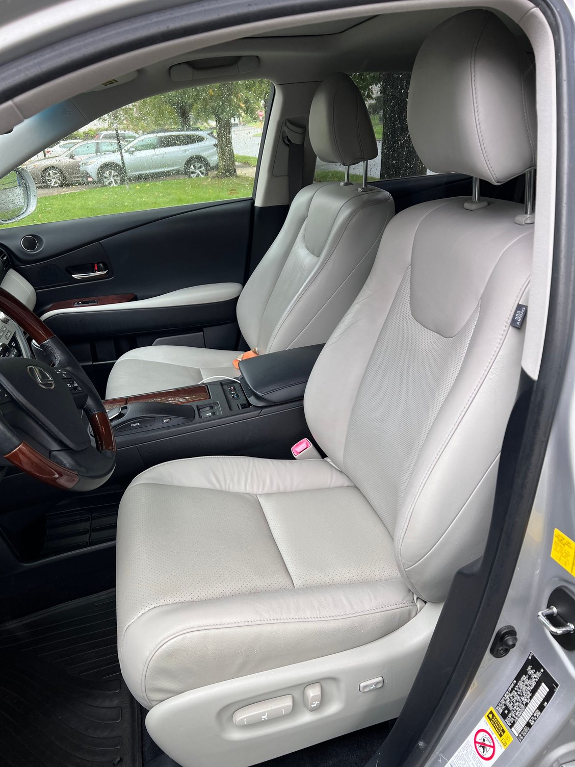

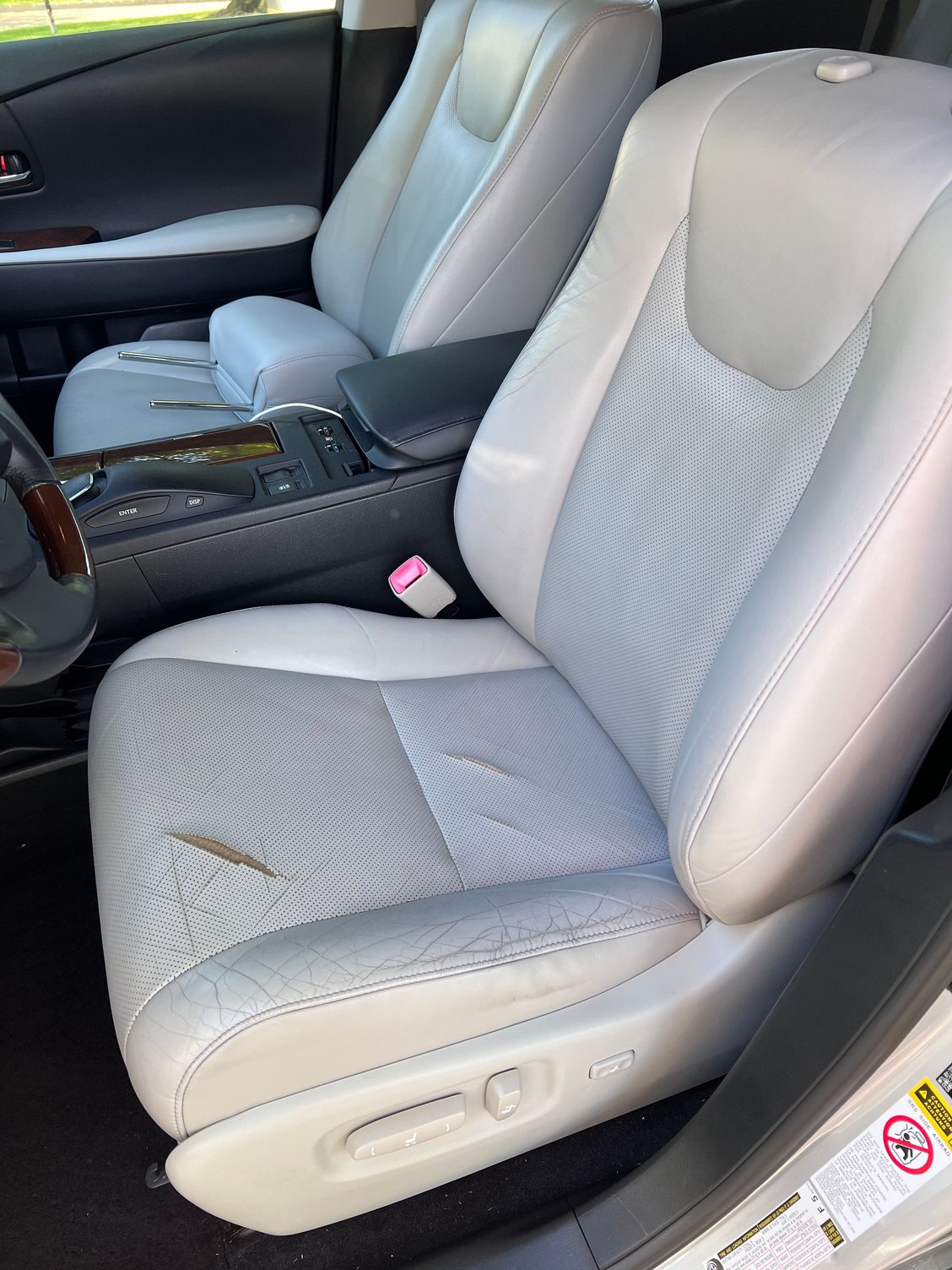

Bottom cushion tore along the perforations. Asked the dealer for repair options and the quote was higher than getting an eBay replacement leather, plus the repair would’ve closed up the perforations and not looked good anymore. Priced out original leather vs eBay and went with the budget friendly option as this isn’t my vehicle.

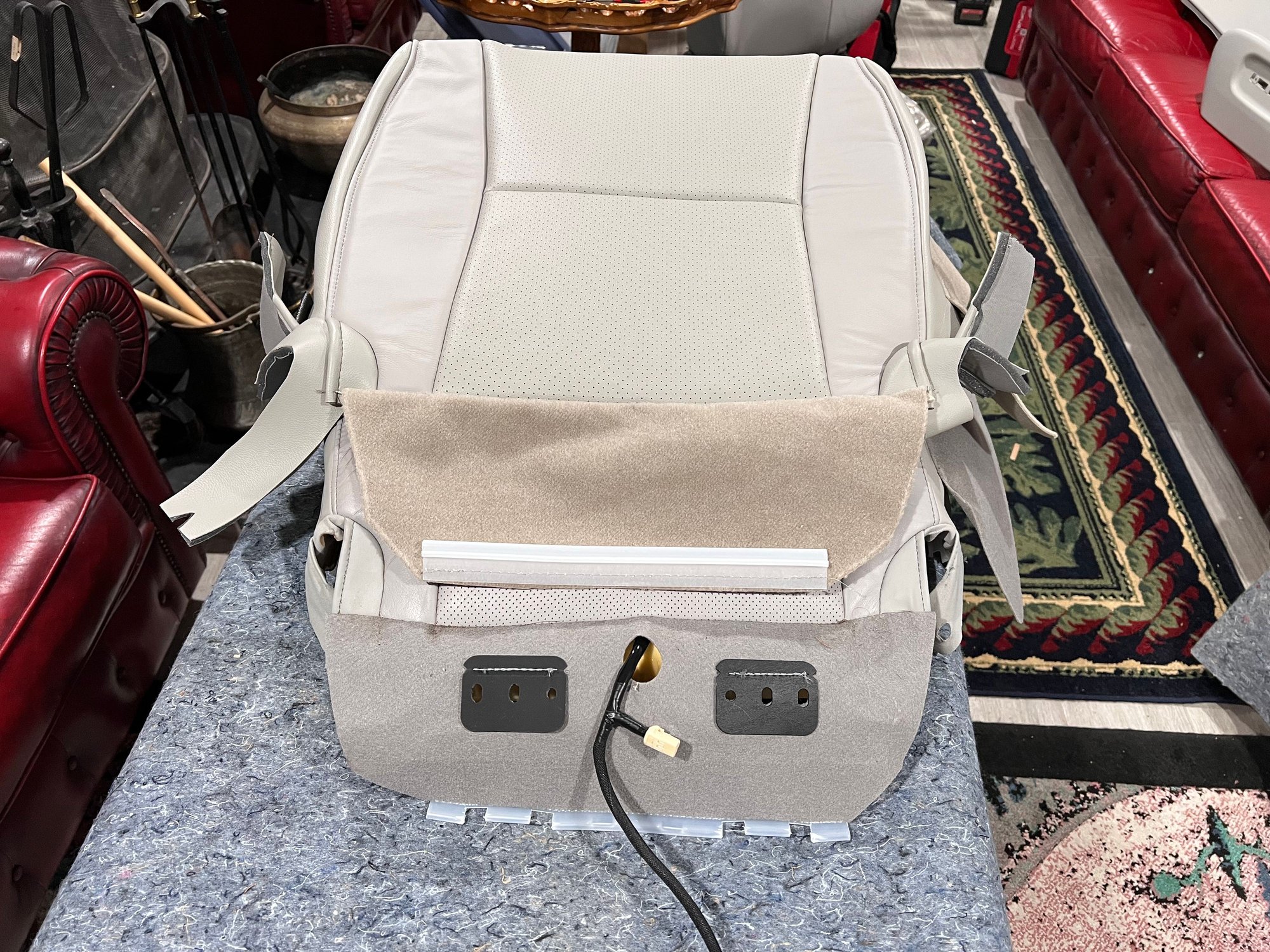

A few observations on quality of the eBay kit. The leather texture is rougher, the perforated middle section has wider spaced holes and is a shade closer to beige than gray. The carpeted section that covers the right and back sides is beige instead of gray. The inner structure that attaches to the hog rings is much cheaper looking than what Lexus designed. For example, the strips that attach to the foam cushion are made out of cardboard instead of wire! You also have to transfer the heating pad which comes included with the Lexus leather. In addition, I had to transfer the back wire holsters that were sown into the original part - annoying to do. However there is a large price difference, $160 for eBay vs $700 for Lexus.
