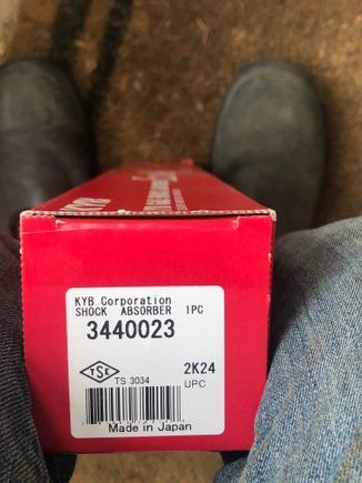

My Bilsteins on my '14 RX and buddy's Chrysler 300 were made in Mexico too, holding up and performing amazing. Better than China Amazon stuff for sure
The KYBs are made in Japan if anyone's wondering. I still prefer the B6's characteristics

I think the KYB's from rockAuto excelG and stuff are not made in japan

Originally Posted by MattRX
ahh different models.
You have FSport

It was just bare assemblies. No springs, although KYB does make them with the springs. I did not remember if those were made in Japan or not.

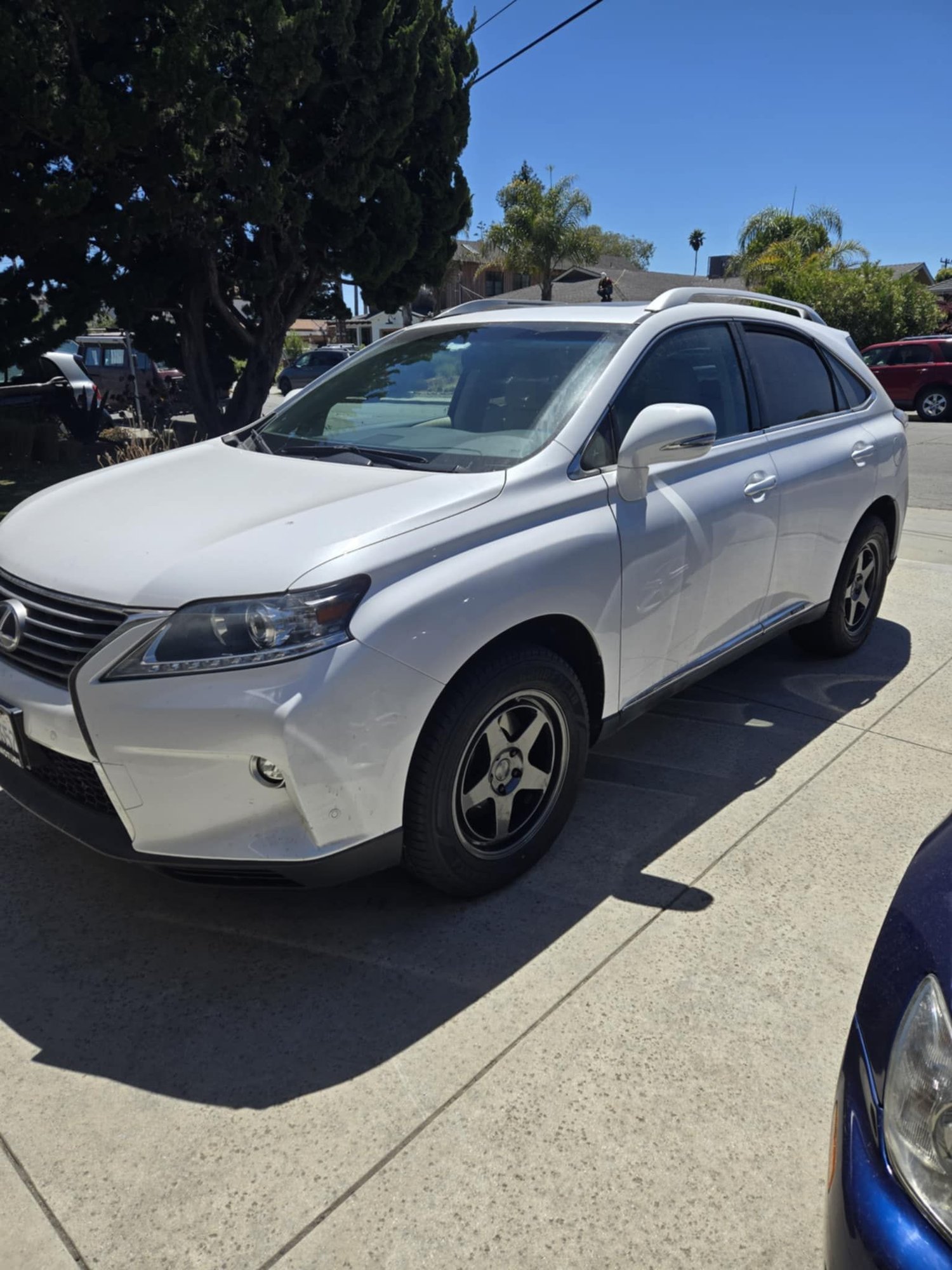

OK did the install last week and I have to say it was kind of a disaster. The bungie cords I had supporting the spindles slipped and my axle separated from the CV boot and then when I went to do the other side the other axle separated as well just from me moving it around to get the struts in position (( I have done suspension on many cars and never had this happen but oh well... My RX ended up getting new axles as well as shocks and struts, I also switched to the Sienna end links but I have to say they looked very similar in thickness to the stock ones and I doubt they make much difference but they were cheap and don't require the hex bit song and dance to get them out,
With all that being said, the car handles AMAZING with the bilstein B6's! its night and day. I used to bounce around and feel jostled going around even small corners, and the nose dive from braking and lift from accelerating.... this thing is so much more level and smooth, it feels like a whole new car.
I also threw some Kansei KNP wheels on it that look pretty sweet IMO. I'll try to get some pictures of it tomorrow. Thanks to everyone who figured out this swap was possible and to clutchless for responding to a 10 year old thread
