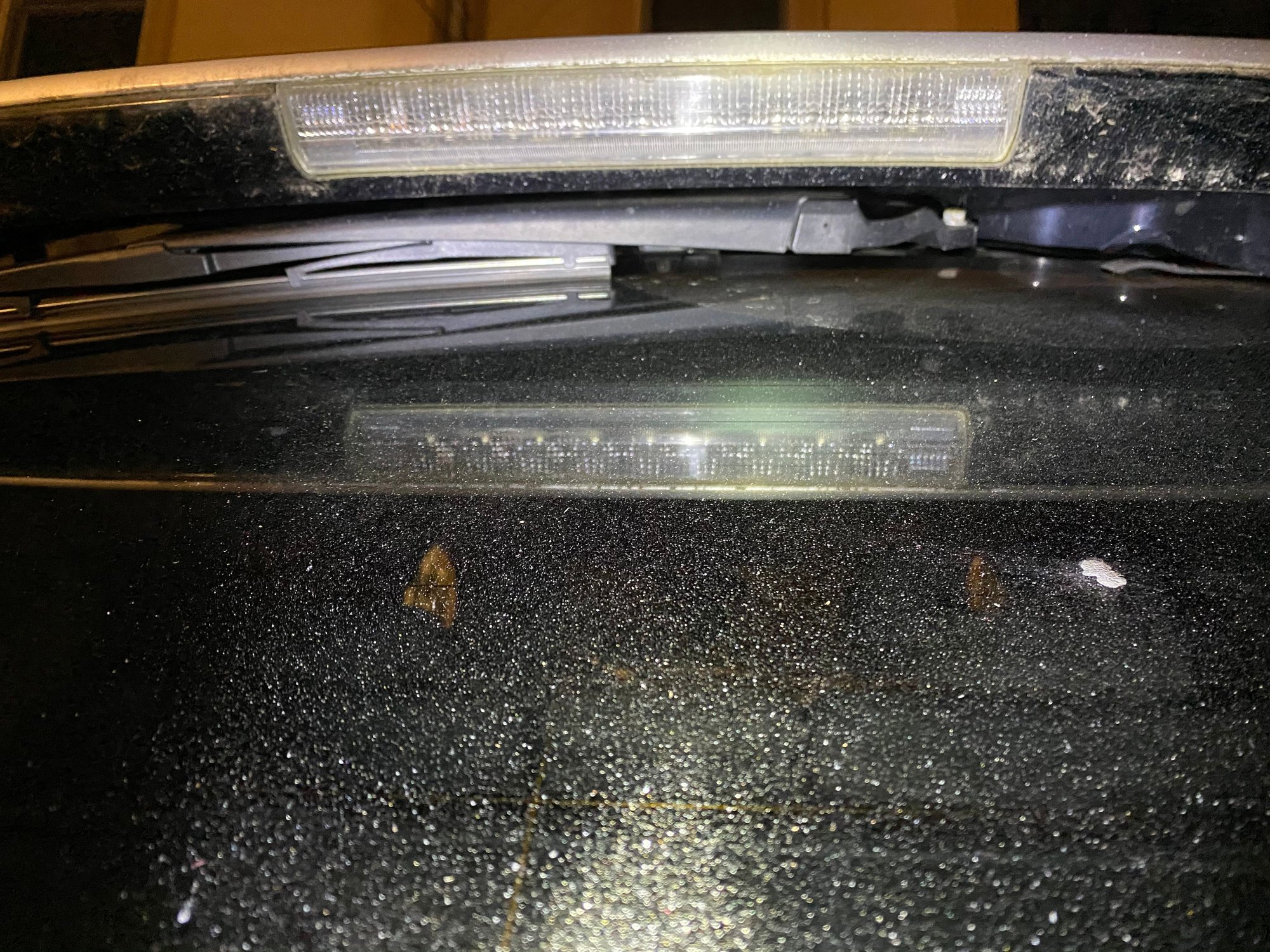

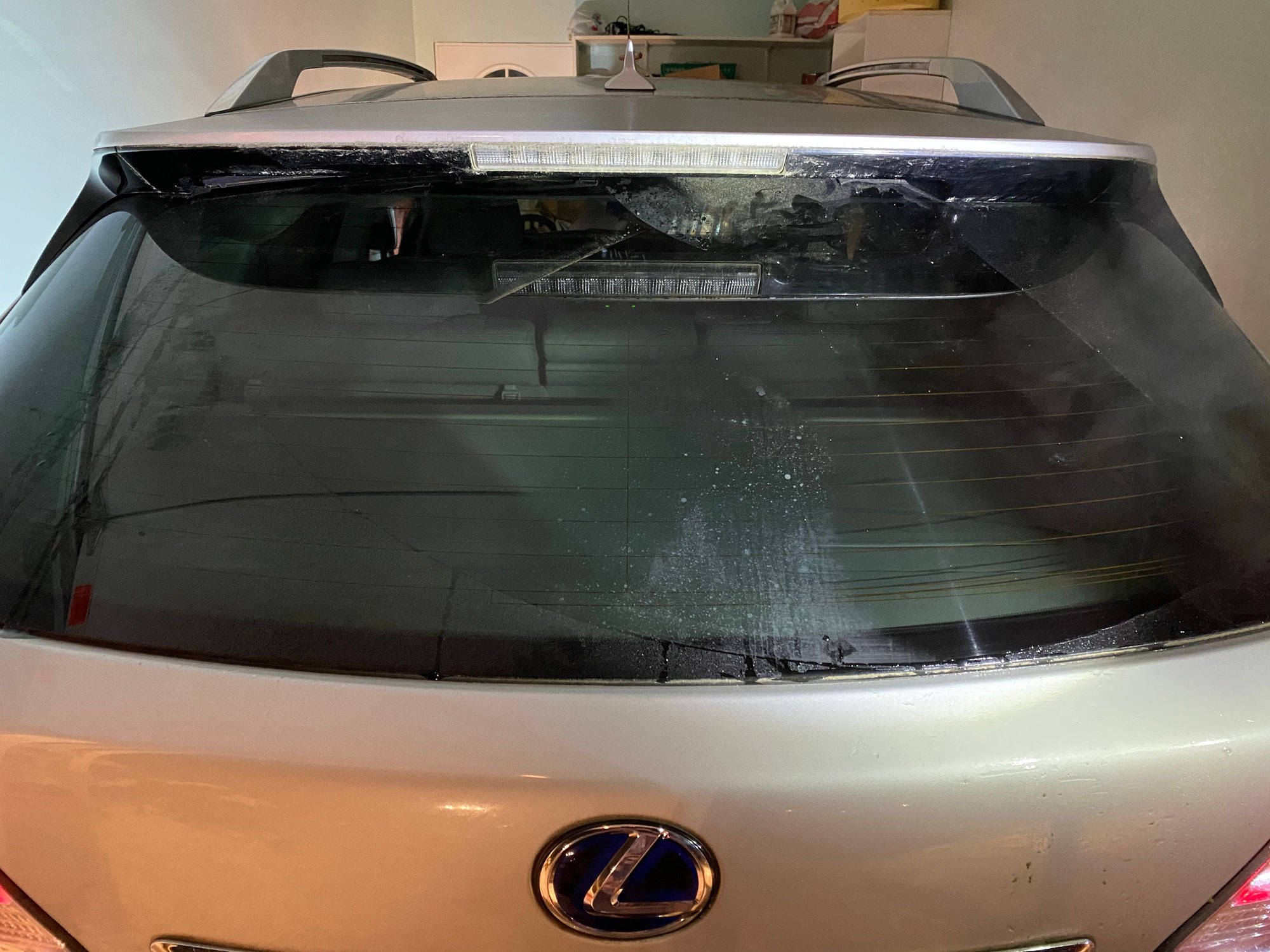

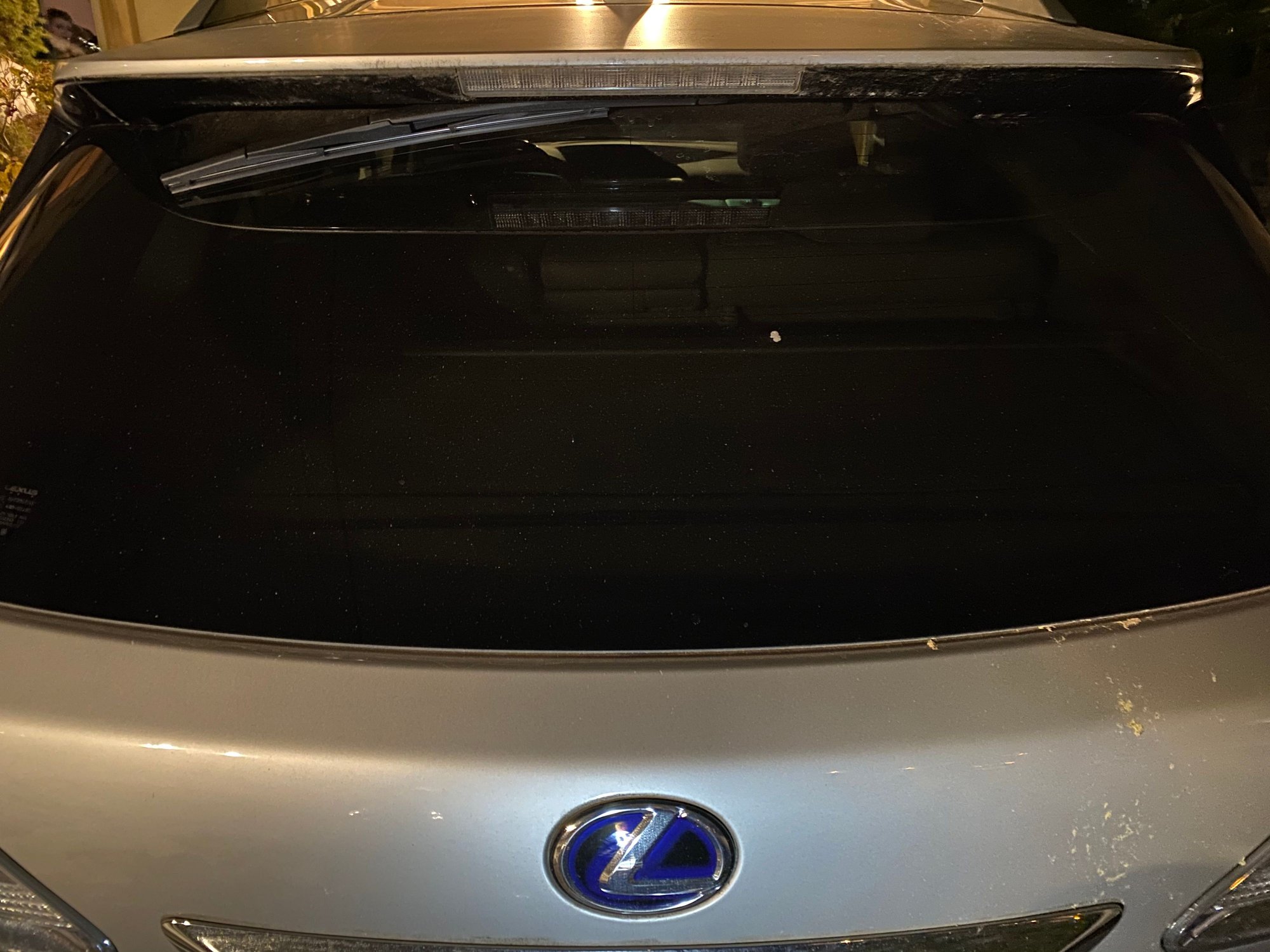

I’m curious if this is normal or if an adjustment needs to be made somewhere.
I noticed the wiper arm sits a bit low and doesn’t go all the way up into the rear spoiler. Maybe somebody messed with alignment while trying to replace the wiper arm? Not sure.
2010 RX450h
44,600 miles
I used this video as a reference of what I think it’s supposed to look like.

Just as the video shows, you should not easily be able to see the rear wiper. Only putting your cheek near the glass and looking up inside.

Im gonna try that. I’m very familiar with the winter mode on the front wipers on both my ES’s, didn’t think about that but it’s a good idea. I’m gonna observe the full travel and do a video recording as well. Not my personal vehicle so kind of figuring it out as I go.
Old Feb 9, 2021 | 08:41 PM
Hayk's Avatar
Hayk
Joined: Feb 2009
Posts: 4,119
Likes: 311
So there is no winter mode. I ran the wiper arm and realized it was hitting the spoiler on the other side. Loosened the 10mm bolt slightly and tucked the arm all the way in - problem solved. My guess is somebody pulled it down trying to replace the wiper blade. Thanks for your help!
