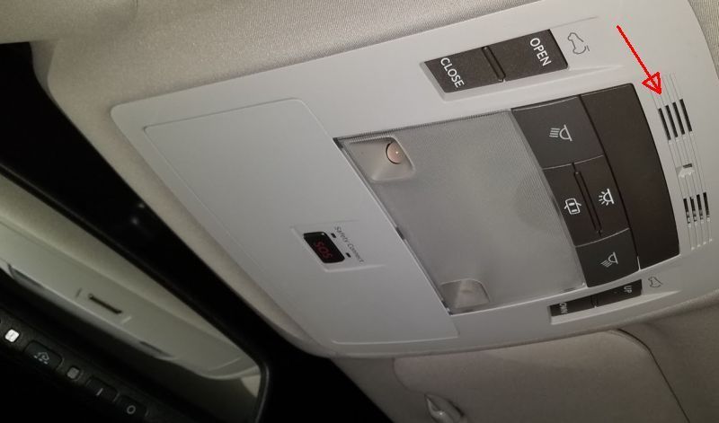

I long ago gave up on using the in-car bluetooth setup on my 2013 RX350 for phone calls, due to repeatedly hearing from the 'other party' that I sounded terrible (tried different phones, no change). I'm actually using the original wired headphones that came with the phone to make calls, and it works great .. but I'd like to revisit the bluetooth solution.
Looking at the roof-mounted microphone assembly (in the dome light/sunroof control cluster), it occurred to me, could I remove the microphone from that location and somehow (with lots of experimentation, etc) reposition it to be closer to my mouth. Step 1 would be to find the mic - presumably surface mounted on a circuit board - and then either remove it and attach to a piece of wire, or, just wire in a new mic. Has anyone messed with the microphone on this car?
I know it would look silly with a dangling mic, but I would first do a proof-of-concept then figure a way to make it look good IF it works better.

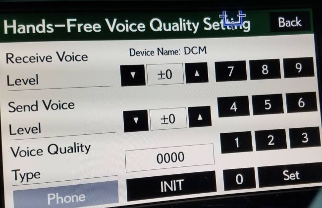

Service Menu ... On my 2013 RX350 Nav model, I did the following:
1) Turn off car. With foot OFF the brake, Press the power button to get into accessory mode (this is so you don't have the engine running while doing this).
2) Press/hold the 'menu' button on the center-console interface
3) Flip the light switch between on and auto 3 or 4 times - until you see the menu appear on the screen.
4) let go of 'Menu'.
The first menu you see, I forget what the choices are but I think there were three, and from that menu I chose something like 'Function Menu'
The two relevant choices seem to be Mic&Voice Recognition and HF Voice Quality Stetting.
The Mic&Voice Recognition looks like this:
The first line is a bit like a 'VU meter' - it reflects the strength of your voice when being recorded. The second line lets you do a test recording, and then play it back - So you press the red 'Rec' button, talk, and then 'stop'. Note - it only records a few seconds so no real need to press stop - you'll typically run out of time. Press 'Play' to hear what you just recorded.
You can use this screen to listen to how well your voice is recorded with your head at various positions, at various levels of your own voice, etc. Note for me, the volume meter hardly reflected a 'blip' with all my talking.
The HF Voice Quality Setting menu looks like this:
It's not clear to me what 'Receive' and 'Send' mean exactly in this context; I tried adjusting both and couldn't hear a discernible difference between them - I need to spend more time playing around with this. I assumed 'Receive' was going to be 'microphone', but that may be a simplistic guess; what is 'send' ...? Also, interestingly, you can only go 'up 1' on the receive (from 0 to +1) but you can go way down to maybe -4. 'Send' has a different range. I made various changes and went to the other screen to 'test', but didn't notice any difference. For the 'Voice Quality Type', I didn't want to mess too much with that - but basically, you use the numeric keypad on the screen to enter numbers and the numbers show in the Type window. My guess is, perhaps, a 'tone' setting? Bass/Treble type setting perhaps? I didn't risk pressing "INIT". 'Phone' is grayed out; maybe if my phone was paired at the time, it would have shown? I'll try again tomorrow with the phone paired.
ALSO - I was able to determine that only the 'left' 'sound vent' on the roof console seems to have an active mic behind it - I made several test recordings while rubbing each vent and only the left one resulted in obvious 'blips' on the level meter.

Did some more testing today, and made more observations.
1) I was able to get into the same menu while sitting at a traffic light with engine running, and do test recordings while driving ... so you don't HAVE to be stationary or have the engine off.
2) My settings are limited to +1 on the 'receive' and +2 on the 'send' settings. I can go larger on the negative side (-5 perhaps).
3) I was able to set 'voice quality' to 'some' numbers but not others. Or more to the point, I could enter any numbers, and press 'set', and exit the screen, but only certain numbers were actually saved. So to test, I would enter a number, press 'set', exit and re-enter the menu to see if it was 'accepted' or not. I could enter 10, 20, but not 15 or 25, or 80. I could enter 300 but not 30, and I could enter 1000, 2000, 3000 ... so as of now, I have no idea what the rationale behind these numbers is.
4) I tried setting both 'send' and 'receive' to a range of values (+1, -4, etc) and also set the voice quality to a range of numbers, and really, I could NOT tell anything different!
5) even with phone paired, the 'phone' button was not available ... but really, for my tests, I'm more interested in the basics anyway.
