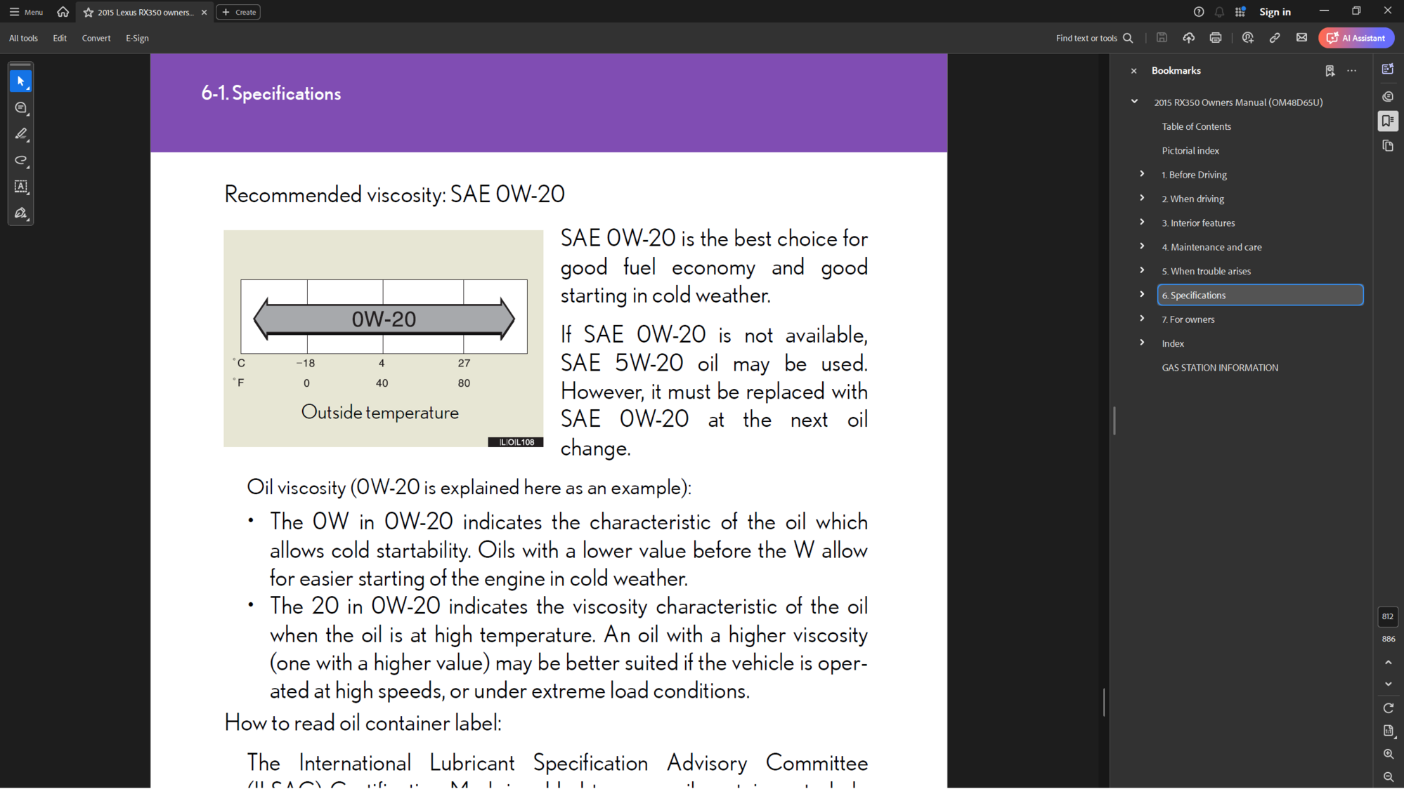

However, I will state that the 2015 RX350 owners manual only allows for the use of 5W-20 engine oil for use in an emergency when 0W-20 is not available and for short term use to be drained at the next oil change. The owners manual makes not mention of 10w-30 as being acceptable to use. So please do not state incorrect information that can damage someone engine. 0W-20 is the proper oil weight(viscosity) to use in the 2010-2015 RX350; not 5w-20 or 10W-30.

That section of the manual has bothered me. Cold start? No such problem here in these parts of Texas. I would like to see the manual for a vehicle delivered to hot climates, i.e. Saudi Arabia or something. What does it say? Would love to see it.

Makes sense, and an easy decision for you given your climate. Down here where 115F not unheard of makes the decision a bit more difficult after looking at the operating temp ranges of 0-20. cuts out way below the temps we see all summer in this area. Which is why I would love to see a manual from a hot region. I've seen people claim the spec is different in hot regions, but they did not provide proof.
