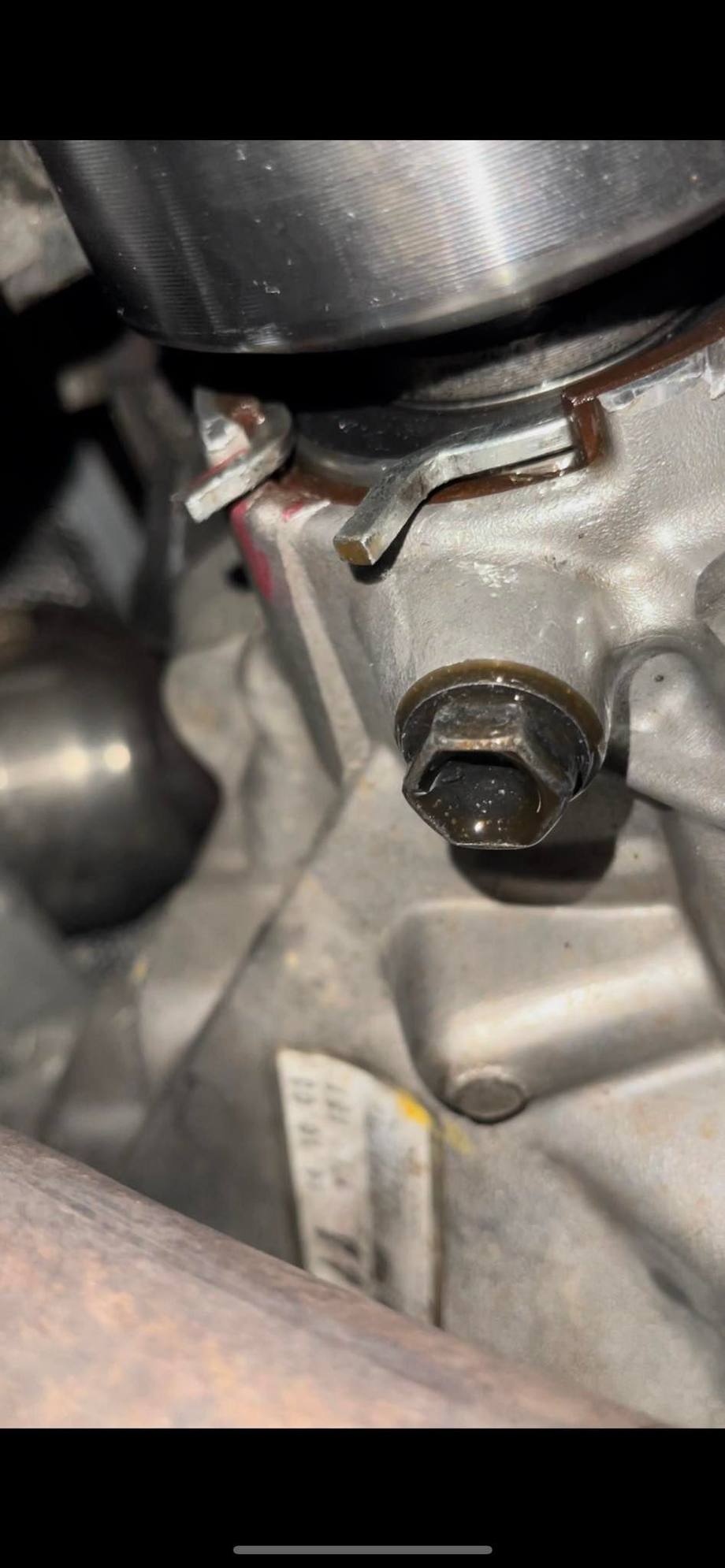

I was wondering what is this bolt for ? Its under the axle front passenger side . It is not the main drain plug for the transfer case oil . AWD . Thanks
I was wondering what is this bolt for ? It's under the axle front passenger side . It is not the main drain plug for the transfer case oil . AWD . Also , is there a breather tube on the transfer case ? Thanks

A few threads down from this one.
https://www.clublexus.com/forums/rx-...oily-bolt.html

This bolt is an additional stop for the axle shaft. That is, to remove the axle shaft, you need to remove the retaining ring and unscrew this bolt a little.

thanks
