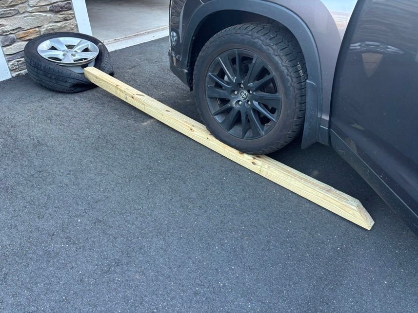

Well...after researching a little more I decided to give it one last try. Great news!! I broke the tire bead. I attached pics but basically, I cut a 4x4 to allow me to drive on it while it presses down on the tire. This was by far the easiest and fastest way that I tried and the only one that was successful. I sprayed soapy solution where rim meets tire and drove right up. See pics.

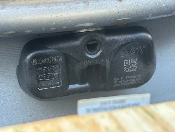

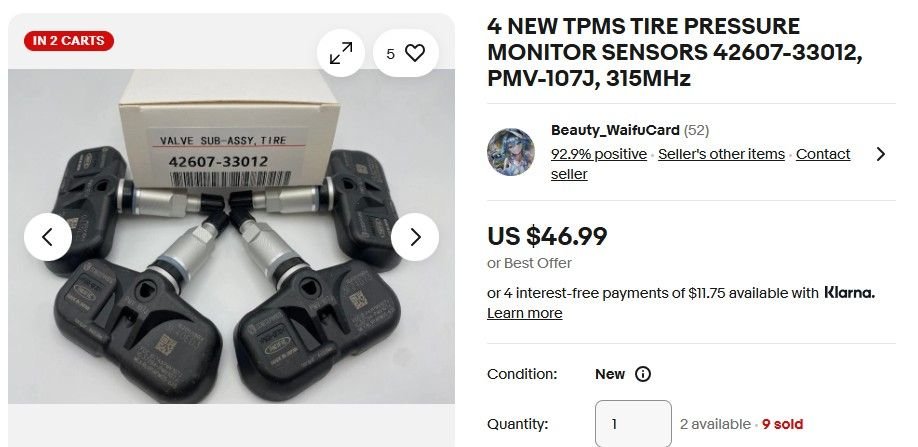

Here is a clearer picture of my current sensor that has been inside the wheel for at least since 2016 and a picture of what I ordered on Ebay to replace it. Once it arrives, I will plan my next step such as buy an OB2 scanner with TPMS capabilities for a few hundred bucks but with many other uses, or buy a cheap TPMS "scanner only". (For less than $100 and still end up cheaper than the dealership)

Posts: 18
Well , my new sensors have arrived from Ebay. They do not look like the originals which are in the pictures above. On the other hand, they did arrive in Toyota OEM packaging so this may not be a bad thing. I read Toyota changed their TPMS design in 2017 so if that is the case I would prefer the new design rather than being sent sensors that were made 8 years ago.
Here is a pic of what I received.
