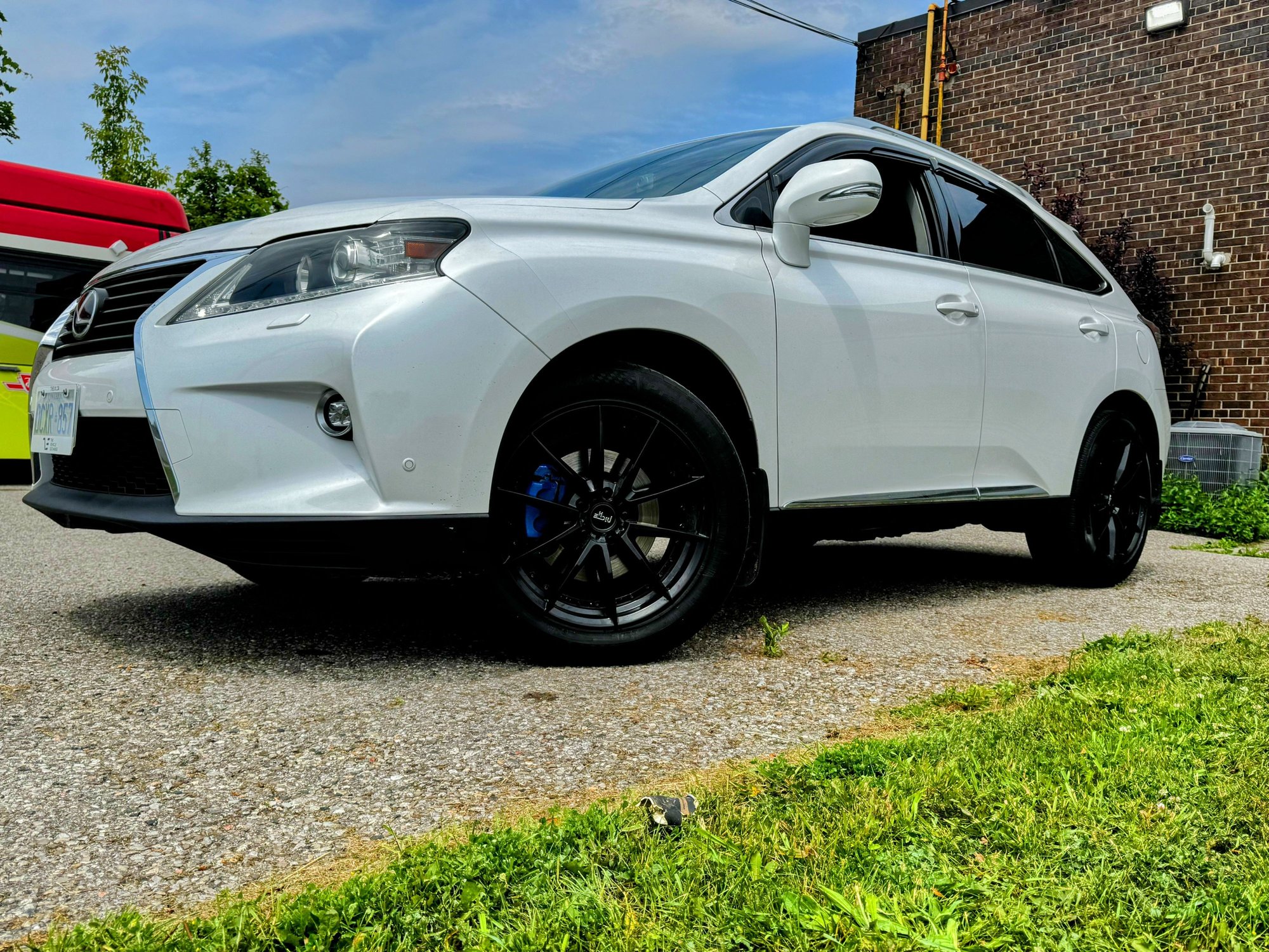

They fit perfectly. No clearance issues. I have been running them for over 5 years and on 8 inch wide wheels. The original wheels are only 7.5 or 7 inches wide. The extra wheel width makes the tire sit a bit wider on the rim. Also I am running 20mm wheel spacers which pushes them out a bit. No problems with fit or clearance.
Here is an old thread where I posted photos of my RX with 255/50/19 tires and wheel spacers. See post 4
​​​​​​https://www.clublexus.com/forums/rx-...n-f-sport.html

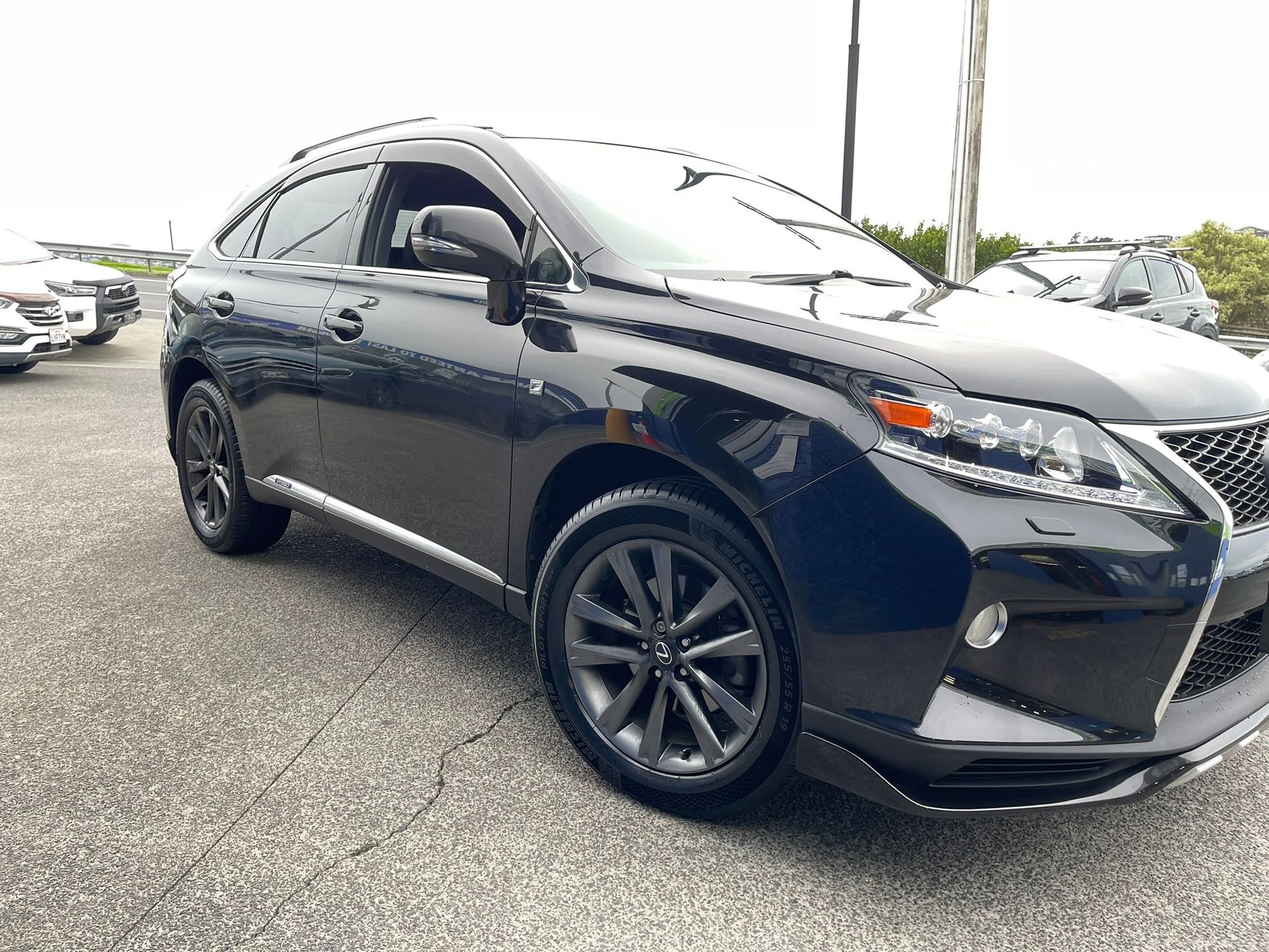

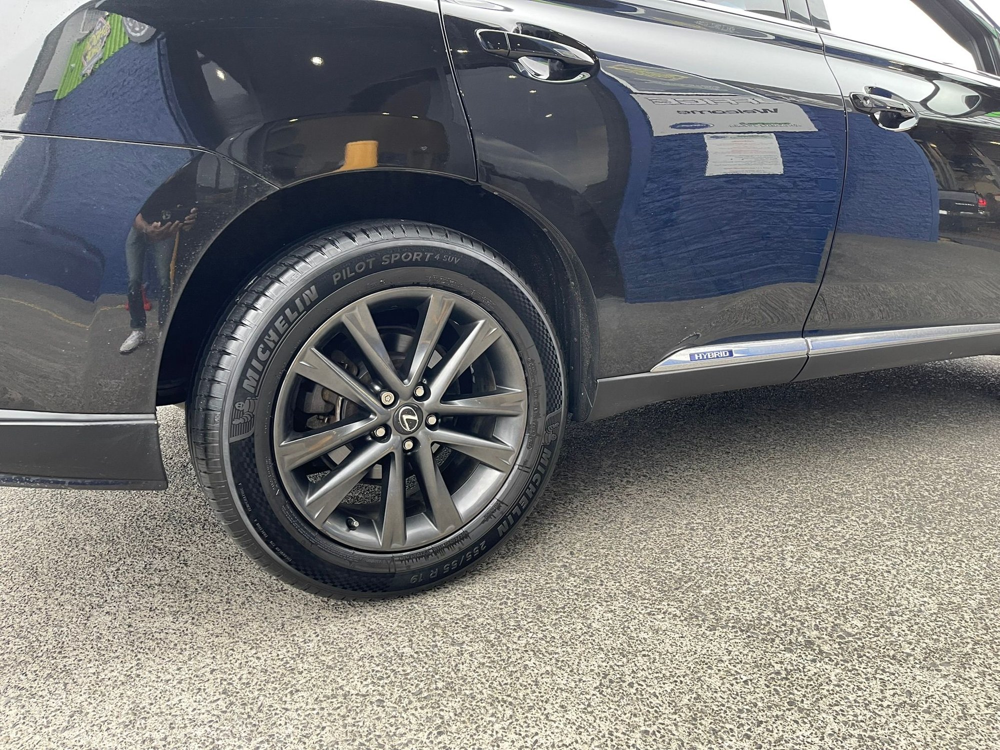

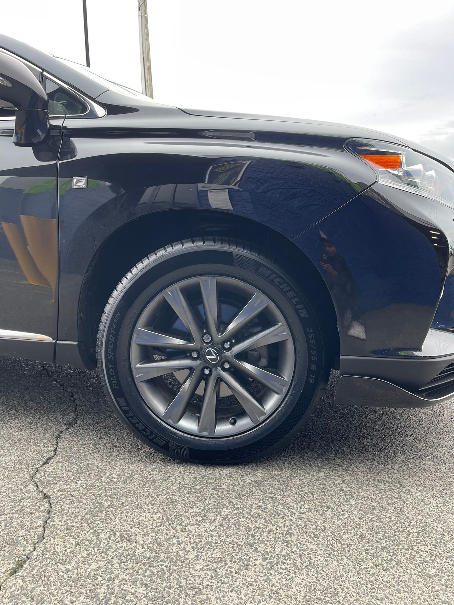

Hey Guys, based in NZ and new to the forum, and just purchased a new to me 2014 RX450H F-Sport. Today upgraded the tyres to Michellin Pilot Sport 4 SUV - 255/55/19s - They fit perfect - no rubbing at all and they feel really nice and planted. As for the speedo, my speedo was previously reading a little bit under eg when it showed 50km/h was actually only doing 48km/h on the original tyres. With the new tyres at 50km/h and 100km/h on the display, the actual speed matches spot on. Hope this post helps.
